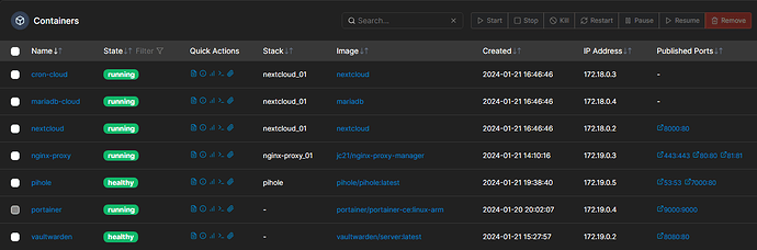

I am having an issue with my local domains, that are configured in Pi-hole on my Raspberry Pi with the latest Raspberry Pi OS Lite (64 Bit).
Every single service is working as it should and the normal functionality of Pi-hole also works perfectly, except the local domains.
The pis address is used in my router settings as DNS and Local-DNS Server. I used the same setup like two days ago, but I installed Pi-hole directly on the pi instead of using docker and the local domains worked back then. It is probably an issue with the docker setup and maybe something that i configured wrong since I am pretty new to raspberry pis, docker etc.
Pings from the pi itself work fine but pings from my personal (windows) pc don't work.
My docker container setup is shown below.

Your Pi-hole is hosted on 192.168.178.7.
Your nslookup via that IP shows that Pi-hole provides the expected replies - if it is queried, that is.
Your client is using your router's IPv6 address instead, i.e. your router is advertising its own IPv6 as DNS server, allowing clients to by-pass Pi-hole.
As your router is of a Fritzbox variety, you can configure it to stop doing so, e.g. Unresolved ipv6 adress in my top list - #4 by Bucking_Horn.
