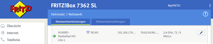

Yes, I use Pi Hole as local DNS server now also and via Conditional Forwarding it is getting the names from the fritz.box. However, the resolution includes always the fritz.box-suffix.
For example: KodiPi.fritz.box (in my client section within PiHole).
Do I still need to use the Local DNS Records to "correct" the names manually? Because I don't want to access my devies via "KodiPi.fritz.box", I want to access it via "KodiPi" (without the suffix).
Is there any solution for the Conditional Forwarding that it uses exact the same names w/o fritz.box suffix?

That should already be possible.
Conditional Forwarding isn't providing the name resolution, your FB is.
Note that an IP address may well be associated with multiple hostnames.
If your FB is handling DHCP, it will provide the correct hostname resolution, as can be demonstrated by e.g.:
nslookup htpc. fritz.box
nslookup htpc.fritz.box fritz.box
Interesting, I thought I tested this... It actually works, you are right.
"htpc" and "htpc.fritz.box", both works, even I did not use the "Local DNS Record" of Pi Hole. Cool :slight_smile: Thanks @Bucking_Horn, good guy :slight_smile:
