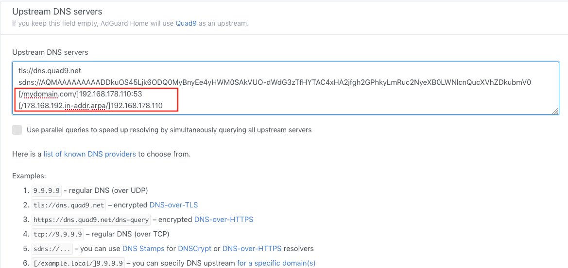

Here's a screenshot of my Adguard DNS config. As you can see I have entered:
[/mydomain.local/]192.168.178.110:53
[/178.168.192.in-addr.arpa/]192.168.178.110
And because I have a DNS server running on my Local network I do not have to enter every single client or "sub.domain.local" manually in to the pihole/lan.list.

Can't seem to get it to work?!
I have add 02-nameservers.conf to /etc/dnsmasq.d/
with this value in the file: addn-hosts=/etc/pihole/nameservers.list
then I have created a file within /etc/pihole /etc/pihole/nameservers.list and I have entered thiss value in the file: --server=/mydomain.local/192.168.178.110
After this I restarted pi-hole(beta) and tried to go to a subdomain wich isn't specified in the customlist but it isn't working. The page isn't loading I get a errorpage.
When I enter the subdomain in the customlist then the page is loading.
You should put
(note the absence of --) directly into 02-nameservers.conf.
Is 192.168.178.110 running a DNS server? Note that your configuration specifies to ask this server for any *.mydomain.local domains. It does not say that any subdomain on mydomain.local has said IP address. (It doesn't appear to mean this for Adguard, either, guessing from the description in your screenshot above).
When you specify
this list does only contain host records, i.e.,
ip hostname
cfm. dnsmasq's man page:
-H, --addn-hosts=<file>
Additional hosts file. Read the specified file as well as /etc/hosts. If --no-hosts is given, read only the specified file. This option may be repeated for more than one additional hosts file. If a directory is given, then read all the files contained in that directory.
Thanks! It is working :grin:
I have change as you suggested the 02-nameservers.conf file
and add the following
server=/178.168.192.in-addr.arpa/192.168.178.110
directly into the 02-nameservers.conf file and it is working!
