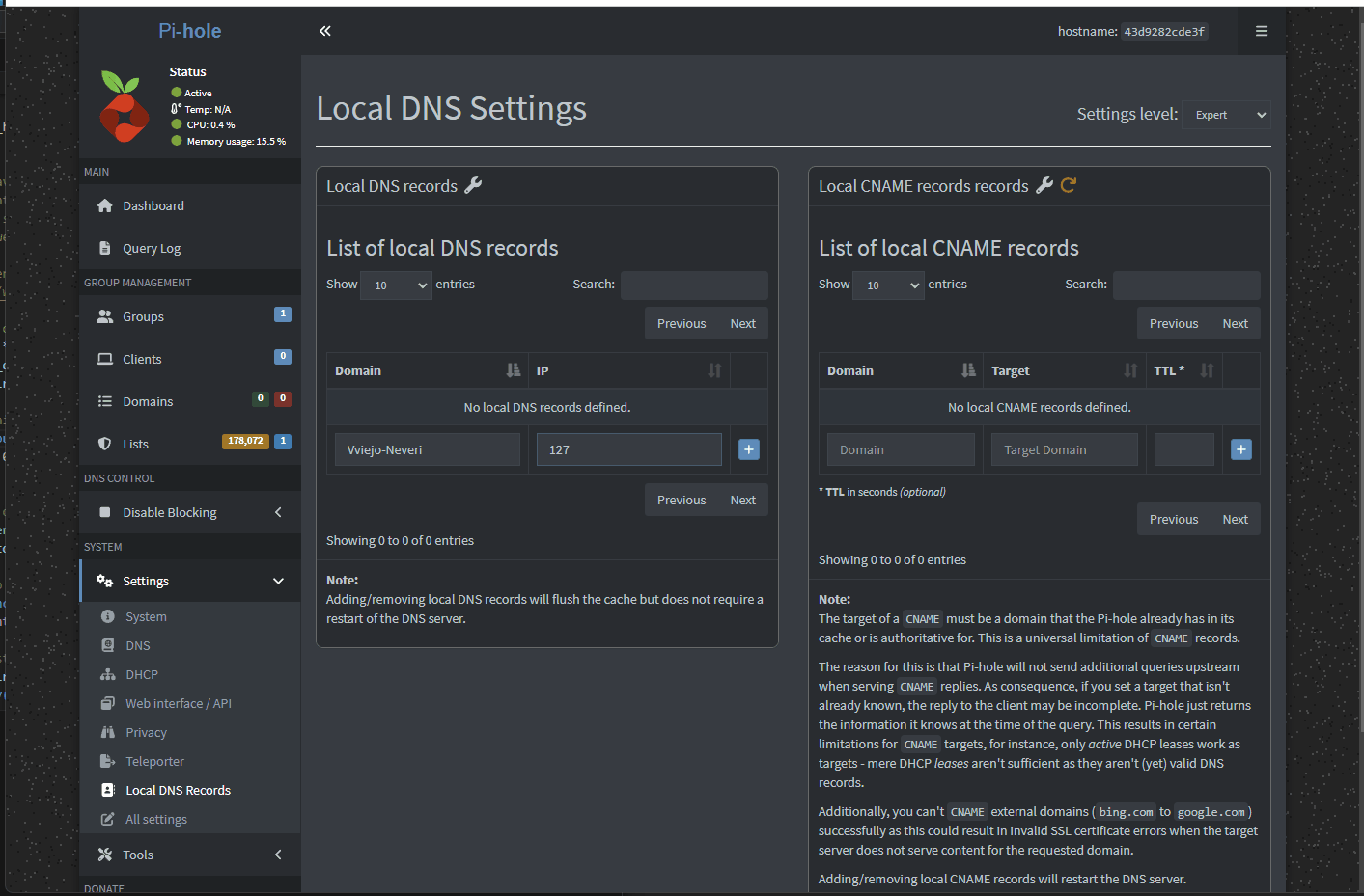

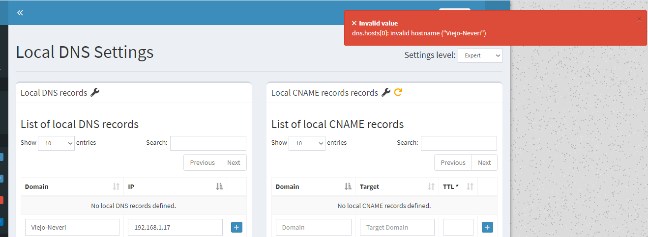

Wanted to add a device to the Local DNS Settings (used to work just fine a few weeks back) but keep keeping the Error message " x Invalid value / dns.hosts(0): invalid hostname (Viejo-Neveri")
Tried without the dash still same and same for other Domains and IPs.
Currently nothing is defined.

Thanks for reporting the issue.
I can confirm this behavior, when using the recent development-v6 image.
Actually every value is considered invalid.
We need to investigate.

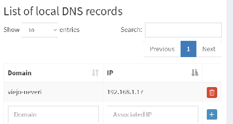

Try viejo-neveri instead, confirmed that works on my test setup. It seems that the config validator is maybe a little too aggressive in this case and is rejecting it due to capital letters.
caps no caps

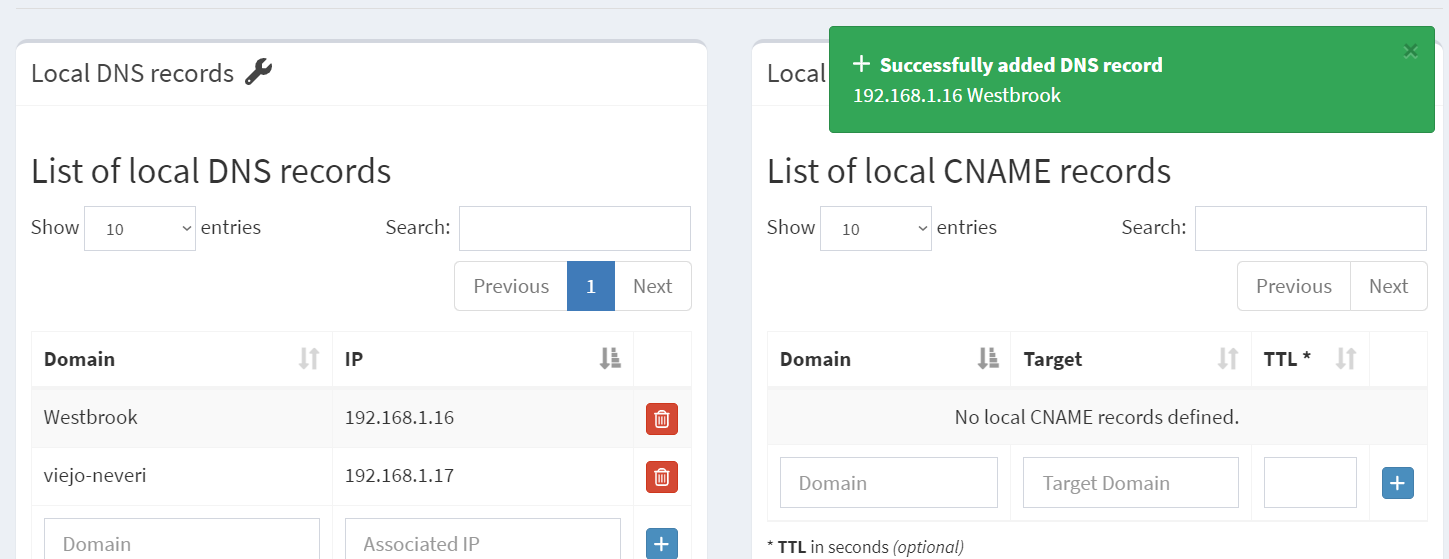

Hello,
Confirming with latest update both upper and lower cases works.
Thanks
