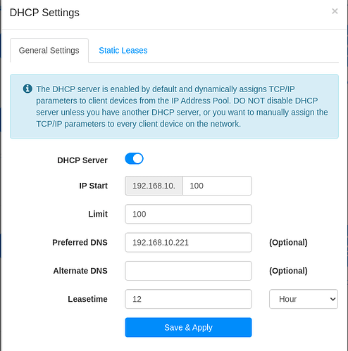

Thank you for the help Bucking_Horn
My router required me to update this in 2 places and I was missing it in the DHCP Server settings
and I already had it setup under DNS
Commonly, it is not necessary to configure your router to use Pi-hole as its upstream DNS server if you are already successfully distributing Pi-hole as local DNS server via DHCP.
Also note that your previous configuration would have allowed your router to by-pass Pi-hole via 8.8.8.8.
As stated in the linked docs, Pi-hole has to be your only DNS server.
