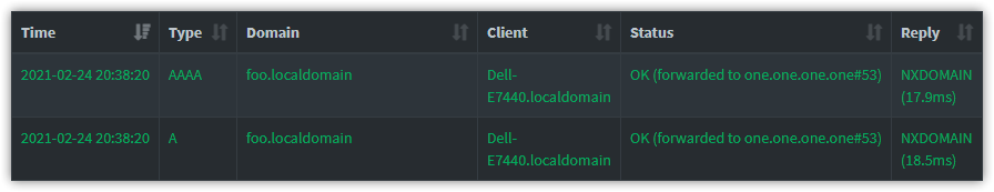

I'm seeing this in the query log when searching for foo:
You need to add both a record for the plain hostname as well as the FQDN for your local domain (aka search suffix), e.g. foo and foo.localdomain.
Some software may choose to query both, so its best to safeguard for that.
It doesn't fully explain why your browsers won't resolve the plain names, though.

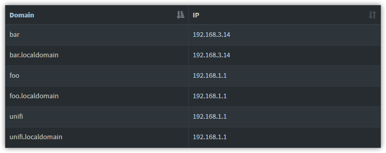

Aha! I added a record in Pi-Hole local DNS records for both, and it's now working! I can now access unifi/ and foo/ etc.
My records list now looks like this:
Thanks very much for the help all!
