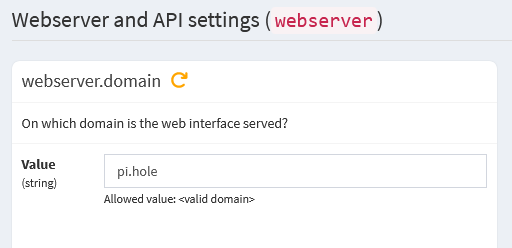

There is no VIRTUAL_HOST variable in v6.
If you just want to change pi.hole, you can use this option:
Great thanks.
FTLCONF_webserver_domain worked. But still can edit pihole.toml to take affect.

Yes.
Try FTLCONF_webserver_domain.
Note:
Every FTL setting can be set using the format:
FTLCONF_ + the setting (replacing the . with a _)
