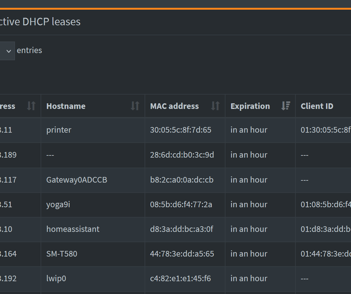

Please share a screenshot showing active leases from Settings | DHCP.

Clients have an active lease. It is currently set to 1h and I have forgotten it on the phone and reconnected with no problem.
