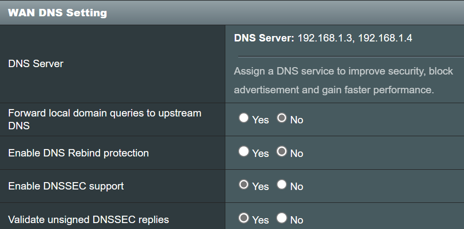

Recently I did upgrade my router to RT-AX88U Pro running merlin firmware 388.3 "https://www.asuswrt-merlin.net"
I know the router isnt in your neck of the woods, but on this router firmware, I wont get DNSSEC unless I "Enable DNSSEC support" is checked. I thought "UNBOUND" took care of that. but if I don't have that enabled, it will fail DNSSEC validation. "https://internet.nl"

The DNSSEC settings on your router apply to the DNS server running on your router (on 192.168.1.1). If something uses the router for DNS then it will have that DNSSEC protection.
In your case your Pi-hole (with Unbound) is your DNS server (on 192.168.1.3) and the router is giving out this IP address for clients to use for their DNS. Unbound is always doing DNSSEC so you are protected. If you want to see this DNSSEC info from Unbound you can enable Settings > DNS > Use DNSSEC then Save in Pi-hole and it will show an extra row in the Query Log for the DNSSEC results.
A couple of extra points.
First, your router's DHCP is also giving out address 192.168.1.4 as a second DNS server to use. If you want everything to use your Pi-hole then you will have to remove that from the router's DHCP settings so it is not being given out.
Second, if you are finding that you still need to have the DNSSEC option on in the router for the tests to say it's enabled, it implies that the client that you're testing from is using the router for DNS. Since the router's DHCP is not giving itself out as a DNS server to use, that implies the client's DNS has been manually set to use the router. Worth checking if this happens.
