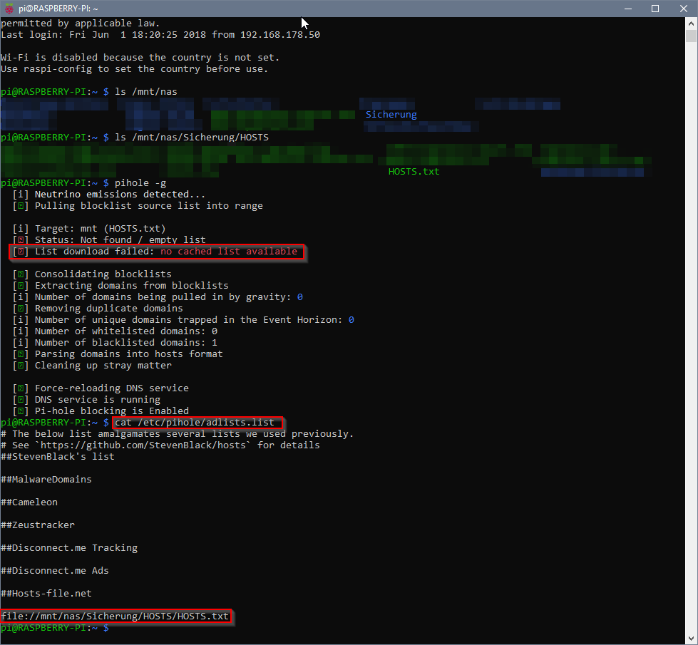

Thanks for the response. Unfortunately that does not work. I tried the file URL already, but did it again now:
The file is accessible and works if loaded from a webserver.
And about the second thing: I don't care really if the Pi get's busy since this is a private network with approx. 30 clients maximum and it's a powerful Pi 3B+.
Can you access the HOSTS.txt (cat the file) from your console as pi?
Is there an output when running cat /mnt/nas/sicherung/HOSTS/HOSTS.txt ?
File might have inherited permissions from the NAS and might not allow access under pihole user
See second screenshot - yes, it's accessible. The share is mounted with the credentials the NAS expects :slight_smile:
change entry to file:///mnt/nas/sicherung/HOSTS/HOSTS.txt
you are missing a / :slight_smile:

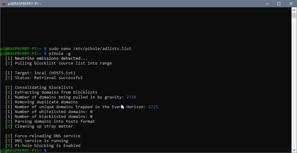

file:// is the protocol, just as https://, ftl://, etc. and /mnt/nas/sicherung/HOSTS/HOSTS.txt is the file name, summing up to three / in total:

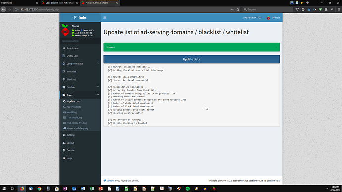

That was it! Thank you very much. Had a variant with 4 slashes, but not three. List does not appear in the web interface, but it is loaded and should work though :slight_smile:
