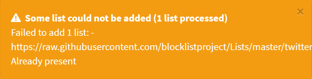

Lists can't add identical url twice (blocklist / allowlist)
Assume the following scenario:
Administrator wants to block twitter, using this list for all users (blocklist), but wants to ensure twitter is fully reachable for users in a specific group, by assigning the same list (allowlist) to a specific group (allow_twitter).
To ensure this works, the lists needs to be entered as blocklist ( -> gravity) and as allowlist (-> antigravity). Currently, you can't add both entries, see error.
See also the identical problem and solution in this FTL change.

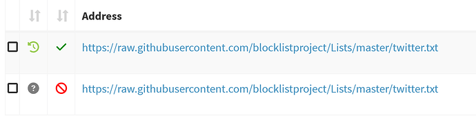

web interface problem: deleting one entry results in all both entries being removed

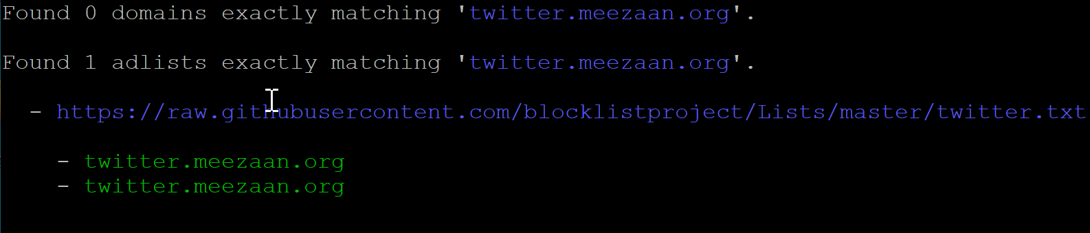

pihole -q when only allowlist exists:
pi@raspberrypi:~ $ pihole -q twitter.meezaan.org
Found 0 domains exactly matching 'twitter.meezaan.org'.
Found 1 adlists exactly matching 'twitter.meezaan.org'.
  - https://raw.githubusercontent.com/blocklistproject/Lists/master/twitter.txt
    - twitter.meezaan.org
pihole -q when both allowlist and blocklist exist:

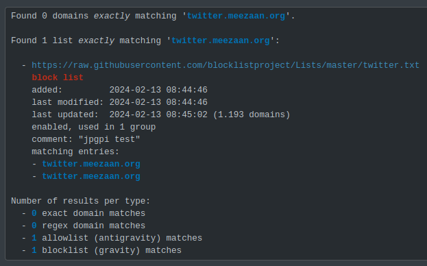

the 'pihole -q' result doesn't indicate if the entry is on an allowlist or a blocklist:

The API returns the correct result
but the frontend currently fails to interpret it correctly:

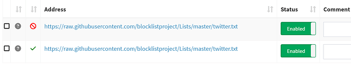

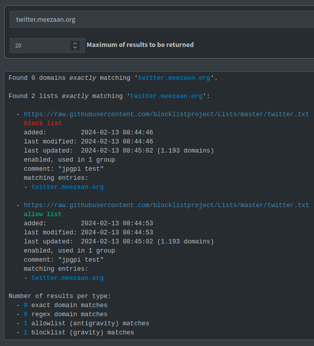

  • deleting, using web interface -> SOLVED
  • web interface / tools / search lists -> SOLVED, output is very informative

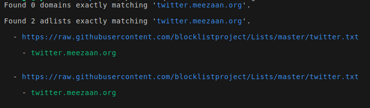

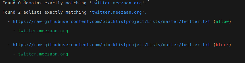

  • pihole -q (command line) -> both lists are identified, but the type info (block list // allow list is missing).
Found 2 adlists exactly matching 'twitter.meezaan.org'.
given the type (allow // block) can be retrieved, it should be possible to display this info on the command line (pihole -q)

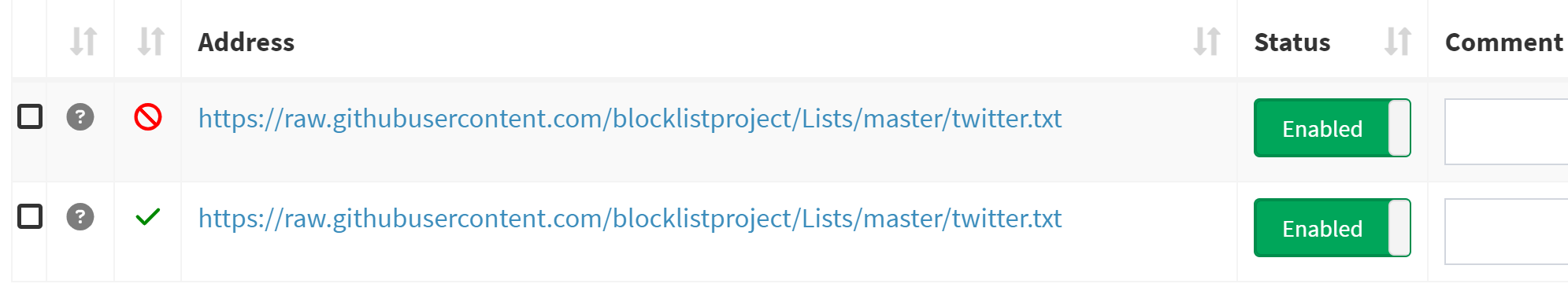

it appears to be possible to add an allowlist and blocklist (same url), so the database appears to be updated.
