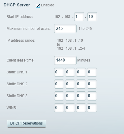

Does anyone know how to get DHCP to pass DNS to the connect client of a Linksys SPNX55-GC?
I tryed before and it just showed the router in pi-hole and all queries from that
This is kind of urgent as nothing is using pi-hole

Hi, I have a linksys router on Gigaclear and it can be made to do what you want - assuming I correctly understand what you want to do!
If you want to use the DHCP from the router then you can just set the "static DNS 1" in the picture you posted above to point to your Pi-Hole. I have done this and it works. The router itself will use your Pi-Hole DNS and it will serve the same to all cilents over DHCP.
Of course the better option is to run DHCP on the Pi-Hole instead. In this case, do the same as above (set the "static DNS 1" value to point to your Pi-Hole) and then untick "Enabled" (very top of your picture) to disable the router's DHCP. You will find that the rest of the values on that screen will grey-out (including "static DNS 1"). However, in my experience, the router will still use the settings. So, the router itself will use the Pi-Hole for its own DNS and because you are running DHCP from your Pi-Hole and THAT is pointing to the Pi-Hole DNS, so will all your clients

On the router, if you go to Connectivity -> Internet Settings -> IPv6 there is an option called "IPv6 - Automatic". This was enabled for me and it was causing an IPv6 DNS address to be passed on to clients. This was causing clienys to request DNS via the router rather than directly from the Pi-Hole. I disabled this and the problem went away.
