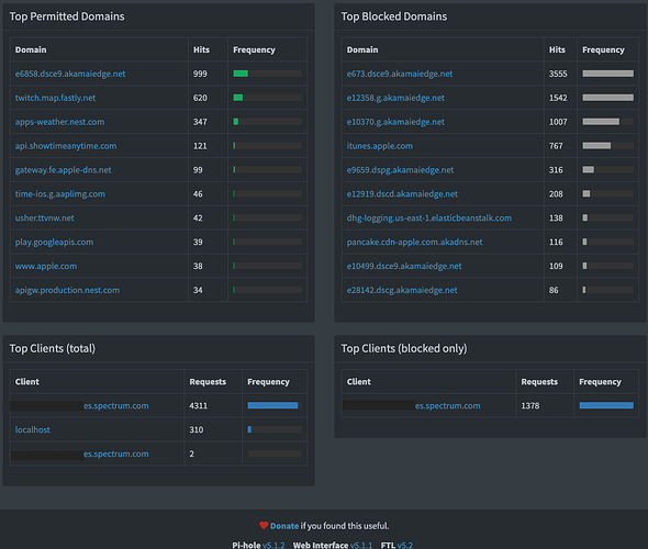

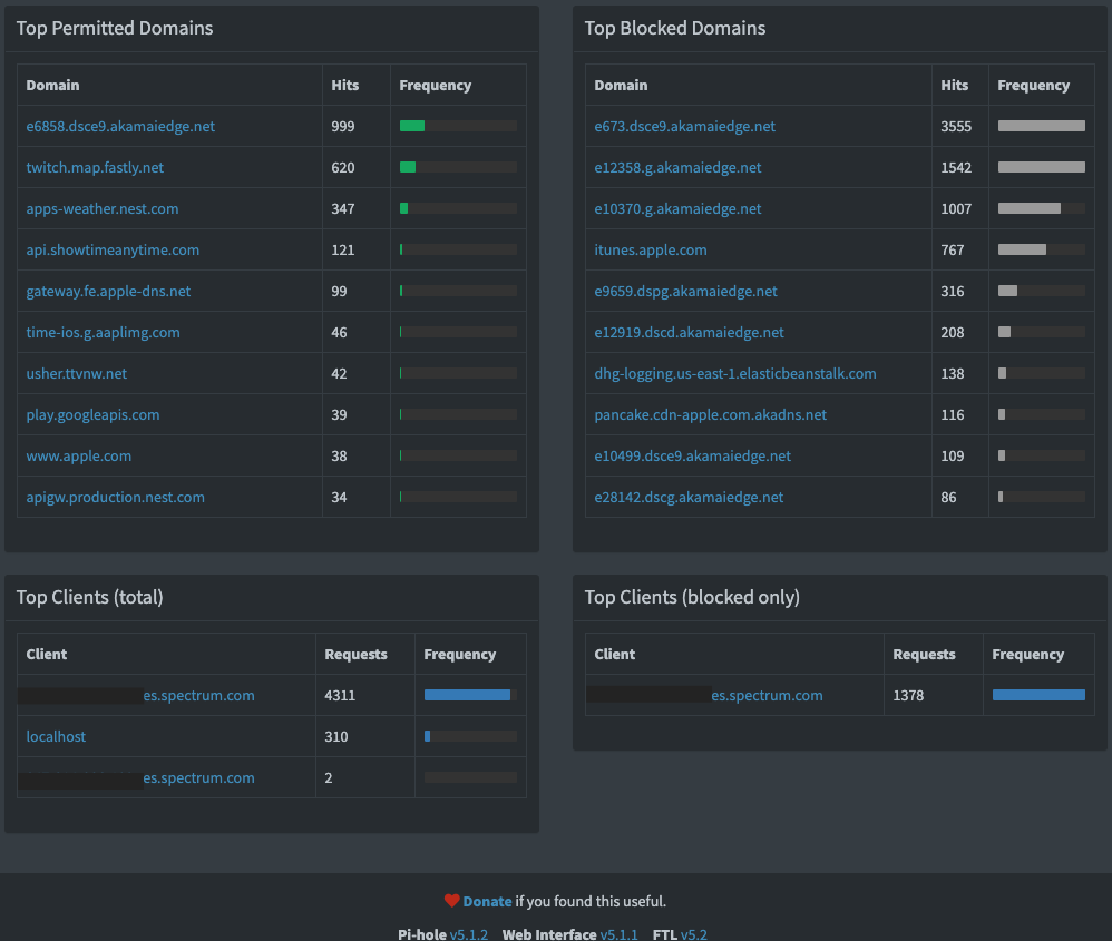

Zero issues for anyone. I keep a close eye on it, and never have any clients show up save for the random scanners (shodan etc) every once in a while.
I'm not using ipv6 at home and it is not enabled on the pihole machine either.
Screen Shot 2020-09-14 at 10.40.02 AM

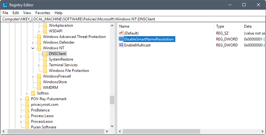

The DNS Client service keeps track of which servers answer name queries more quickly, and it moves servers up or down on the list based on how quickly they reply to name queries.
https://docs.microsoft.com/en-us/previous-versions/windows/it-pro/windows-server-2008-R2-and-2008/dd197552(v=ws.10)?redirectedfrom=MSDN#part-2-querying-a-dns-server
And this bit:
https://www.ghacks.net/2017/08/14/turn-off-smart-multi-homed-name-resolution-in-windows/
