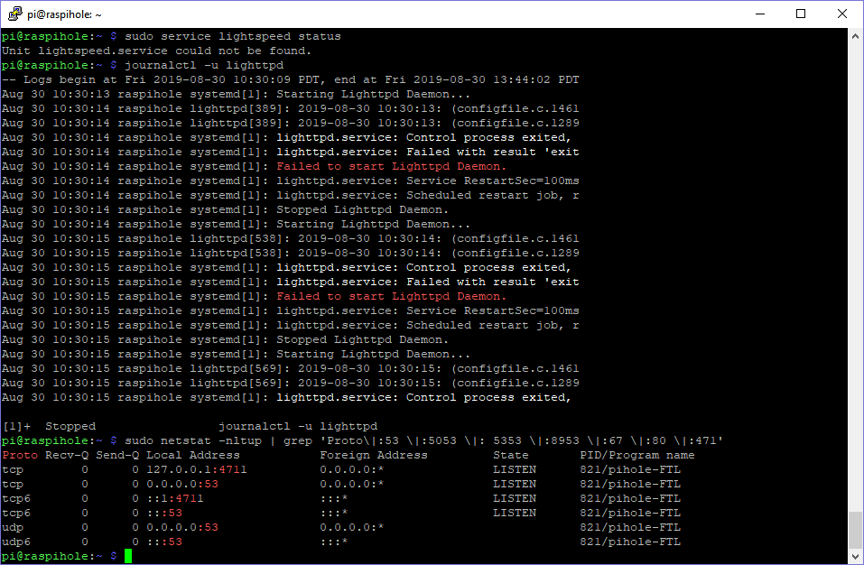

What are the outputs of the following
sudo service lighttpd status
journalctl -u lighttpd
sudo netstat -nltup | grep 'Proto\|:53 \|:5053 \|:5353 \|:8953 \|:67 \|:80 \|:471'

I am now able to access the web console via http://IP_ADD/admin, so apparently that worked and my previous post about 'that doesn't apply' was wrong. I'm simply posting this reply to ask.... what was that? Can someone explain why that worked and what was wrong etc? I am technically minded and extremely saavy at windows, but this is my first linux foray and would really like some technical explanations so I know what is going on - if it's not too much trouble and someone has time.
It is not clear what the original issue was, as the journalctl -u lighttpd output you posted was cut off. The referenced PR changes the uninstall to only remove the lighttpd configs Pi-hole added instead of removing all of the lighttpd config directory. Since your problems happened before running the uninstaller, it may be unrelated.
