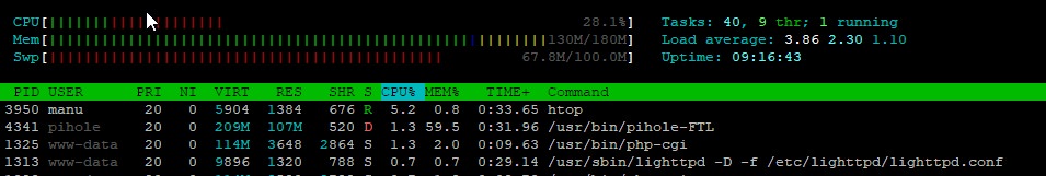

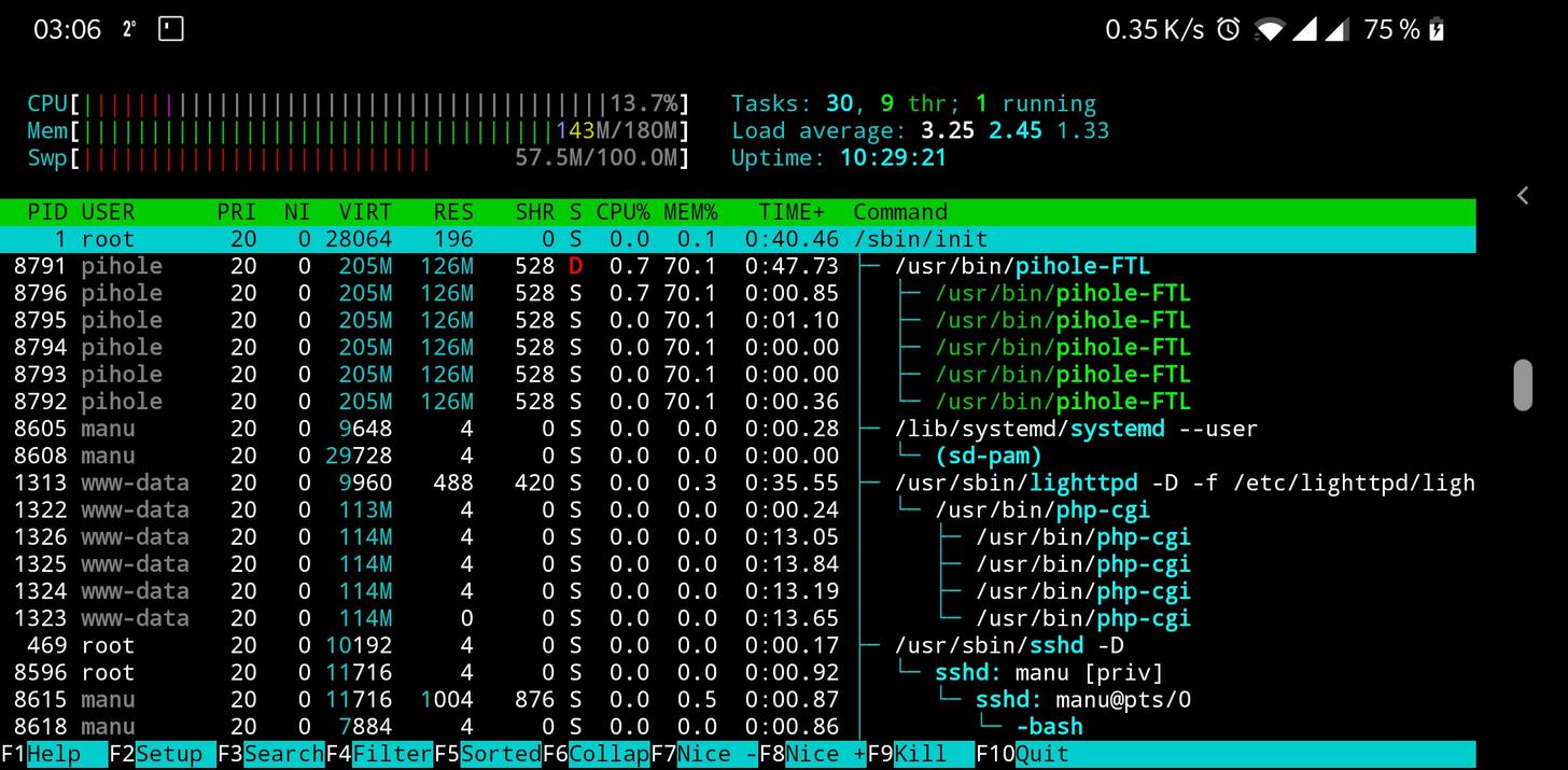

When I start pihole-FTL , CPU increase and memory usage increase quickly up til it starts to swap and the raspberry become extremely slow.
I had to stop pihole to keep control over my Pi.
I use latest raspbian : 9 (stretch) (installed over the week end)
and latest pi-hole installed over the week end also
I checked what could be done and it seems it starts become worst after adding more Ad list, so I dropped all of them :
root@raspberrypi:/etc/pihole# ls -altr
-rw-r--r-- 1 root root 67895045 Nov 18 02:03 gravity.list
root@raspberrypi:/etc/pihole# > gravity.list
root@raspberrypi:/etc/pihole# systemctl start pihole-FTL
then updated gravity again and checked memory, it seems better, but I am pretty sure this is just because there are far less server to block :

How many domains were being blocked when you had the higher memory use?
If your first screen shot was taken with more domains in gravity and higher memory use, you were still only using about 72% of memory.

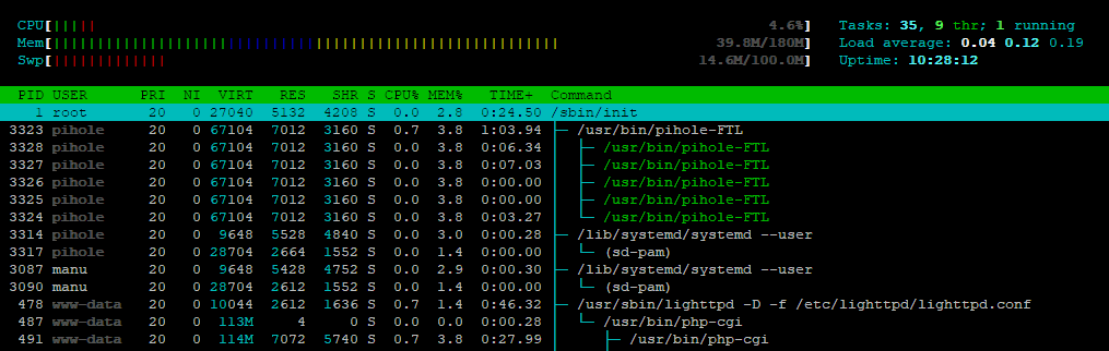

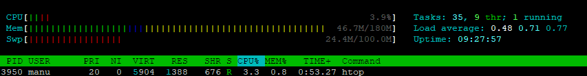

I have drastically reduced the amount of host source :
$ cat adlists.list
http://winhelp2002.mvps.org/hosts.txt
https://adaway.org/hosts.txt
$ wc -l gravity.list
12813 gravity.list
and it is now working perfectly :slight_smile:

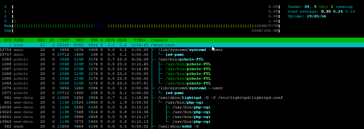

Got my Pi 3 B+ yesterday :slight_smile:
It is much more powerful !
I used the same list of server I tried first :

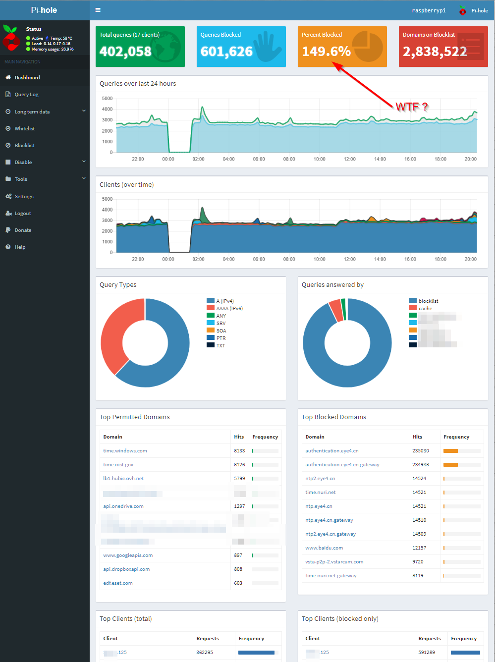

Is this a bug the percentage of blocked queries ?
I have discovered with Pi-hole that a chinese camera was contacting chinese server all the time, that's crazy !
That is a known bug. Will be fixed next release.
