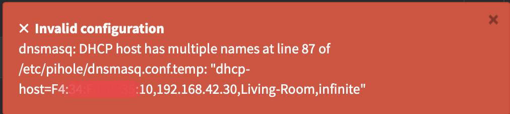

Also, static addresses cannot be added anymore. trying to save the newly added results in this pop-up.
I got the same error.

This is a new check introduced in dnsmasq v2.91test2 we added to our development branches. Adding multiple names was never supported. Even though it was allowed, the behavior was undefined. The dnsmasq mailing list has further details if would like to see them.
I guess the ,infinite at the end is misinterpreted as duplicated host name.
edit This is the offending commit:
Just tested it and indeed removing ,infinite does not trigger the error anymore.

Even without ,infinite You can only add lines one by one.
I can not remove ,infinite. well i can, but it always adds itself back.
