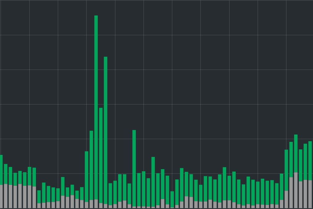

Just for fun, I am putting below what I was seeing with queries in the first couple hours of cloudflared being installed until it figured itself out. This was in the middle of the day with both my partner and I on the network working.
As you can see there was a massive dip in blocked queries. I am going to assume at this point it was user error / misunderstanding as things seemed to have return to normal.
