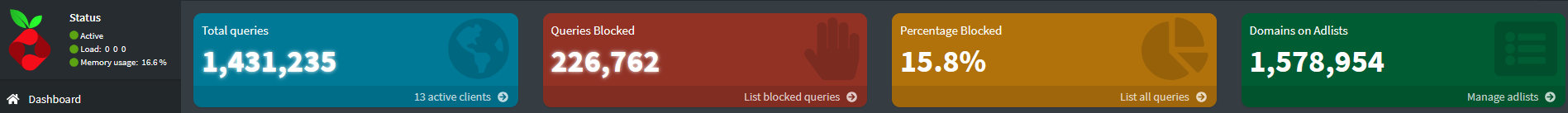

For once, you've applied a change to Pi-hole's web UI - it seems you've disabled the dashboard's client activity graph?
When you have this many clients, trying to load that graph will lock up pihole for a very long time. I've commented it out in the html code for that reason. There have been no other weird configurations made to the install that don't involve the standard variables.

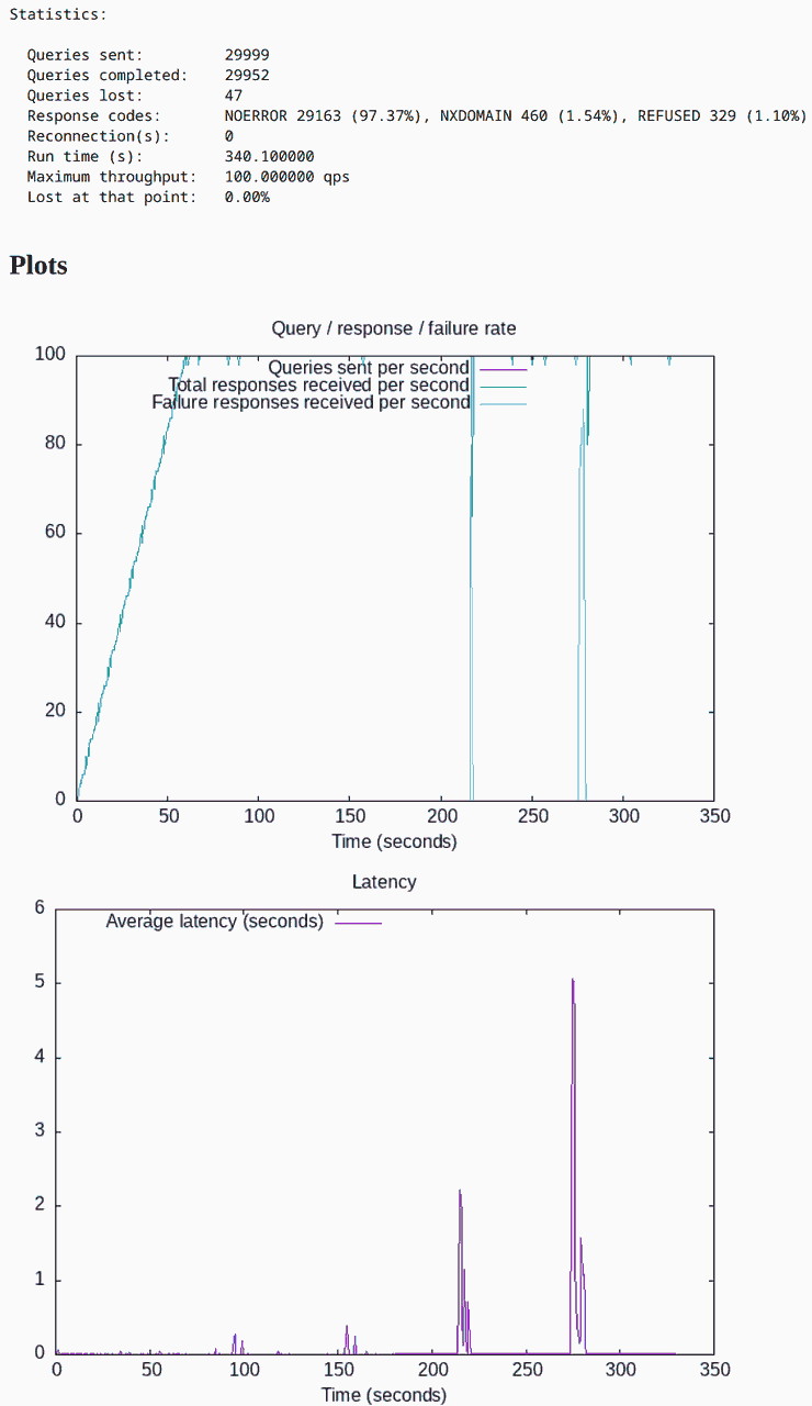

When trying to reproduce your observation hitting a wall at 30,000 queries, with the default DROP in place, my Pi-hole instance would start to exhaust its max concurrent connections and refuse additional queries, and may also drop some DNS requests, but it would not hang.
Response codes:  NOERROR 20757 (71.17%), SERVFAIL 126 (0.43%), NXDOMAIN 6774 (23.22%), REFUSED 1510 (5.18%)
However, while such REFUSED queries may contribute to your observation, a max concurrency warning was absent from your debug logs.

The tests aimed to issue 30k queries during 5 minutes (plus rampup time).
You'll notice that spikes in latency occur about every 60 seconds, correlating with failures to resolve (requests replied with REFUSED), as caused by a maximum concurrency condition, which in turn was likely caused by the database commits.
Max concurrency happened twice (roughly 90 and 150 scs into the run)
[2025-02-12 11:23:57.098 (~90s)]  WARNING in dnsmasq core: Maximum number of concurrent DNS queries reached (max: 150)
[2025-02-12 11:24:57.114 (~150s)] WARNING in dnsmasq core: Maximum number of concurrent DNS queries reached (max: 150)
Also, 47 queries are counted as lost, dropped by Pi-hole when the database was busy, so a client never received a reply for those.
Those results seem quite different from what you seem to observe.
Note that this was run against a Pi-hole on an RPi 3A.

My loadtest show that database commits will impact reply times (going up to several seconds, and a few queries dropped entirely), which could explain dnsdist classifying Pi-hole as down by its timeout rule (but not on SERVFAILs as you observe them).
I also can confirm that enabling EDNS0 ECS would negatively impact my loaded Pi-hole, further increasing response times by ~10 to ~15% during db commits, but mainly doubling the amount of REFUSED and tripling the amount of dropped queries (on an RPi 3A writing to an SD card).
Also, I learned from its documentation that enabling ECS would negatively impact dnsdist's caching: Since ECS may result in client-specific DNS replies (either based on client's geo-location or client-specific blocking rules), a received reply can only be a cache hit for clients in the same ECS subnet. With a /32 subnet as required for proper client identification, that would mean that e.g. one client's reply for google.com won't be shared with another client requesting it - dnsdist would have to repeat the lookup through Pi-hole, and an increasing query count would also affect Pi-hole's database commits.
So with ECS enabled in dnsdist, Pi-hole would suffer twice the penalty: Not only would it have to receive larger size DNS packets and decode ECS information, but also cope with an increased number of DNS requests and larger database commits.
(EDIT: On a side note, ECS may also affect your Windows DNS servers - once that info is in, it will travel all the way upstream, unless you'd have your upstreams strip or replace that ECS information. To that end, could you provide a fresh debug token, preferably one from a Pi-hole configured as used in your production environment, so I have a better chance of reproducing your observation?)
