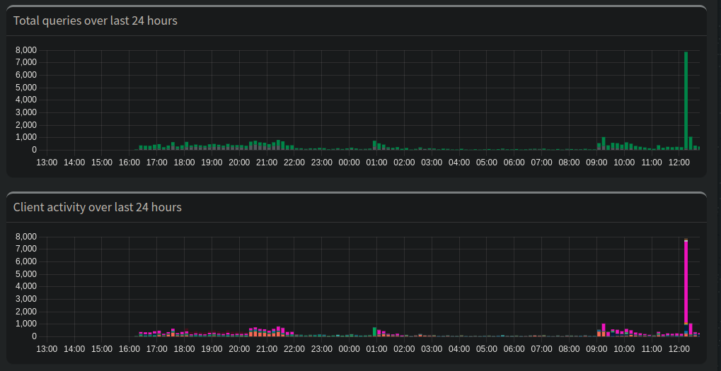

My whole home network went down for the second time and I cannot figure out why.
That is my own laptop, but I have no way of knowing what is behind that or like why is my laptop doing this weird stuff.
I was hoping to find some data on Pi-Hole to explains why, the logs is helping much.
I running Linux desktop and this was never an issue so I am lost haha
When I first setup this Pi-Hole + Unbound Recursive DNS, I did cover the security topics, not leaking DNS, etc. I have this setup running for years flawlessly.
Thank you for any help.

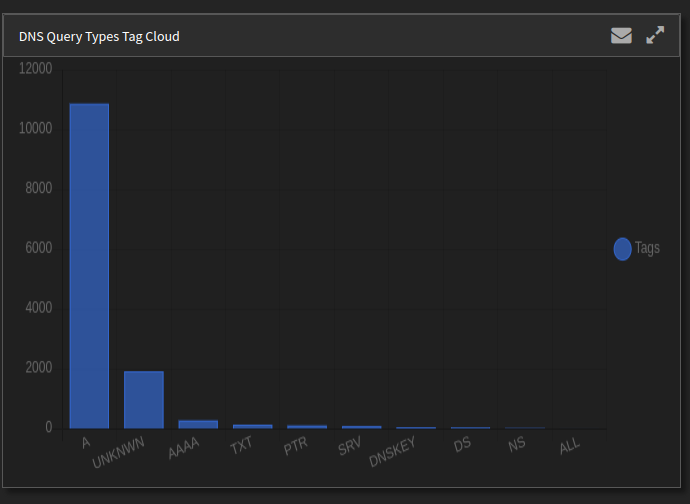

To be sincere idk, I mean, I did check the log but I couldn't find anything other than the usual requests, some requests with empty response, some fail, but I just couldn't figure things out.
I should have paid more attention with Pi-Hole telling me who could be behind all of that tho instead of waiting for the second time to happen.

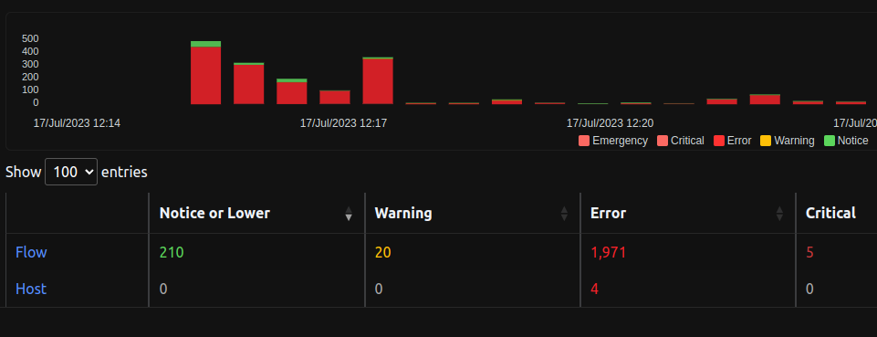

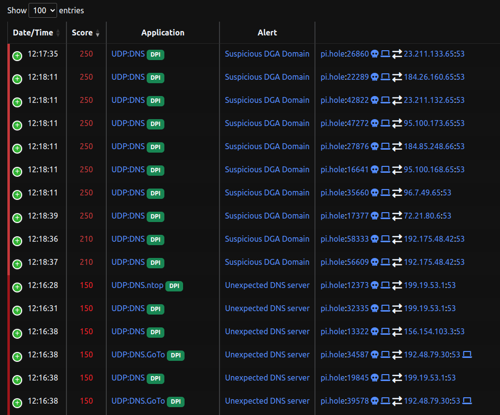

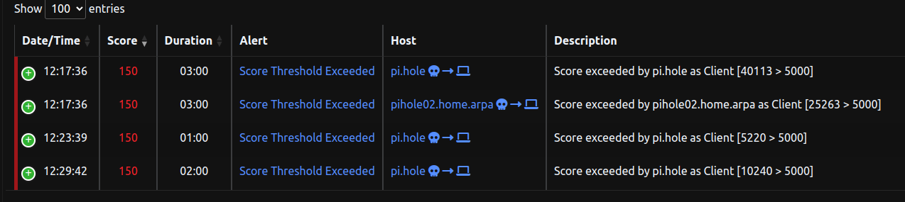

Those graphics are from my OPNSense router which is also running Ntopng and Zenarmor (IDS/IDP).

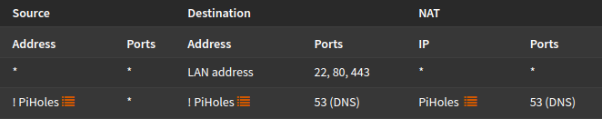

I have a firewall rule to force everybody requesting DNS to be redirected to Pi-Hole and only Pi-Hole can go out, also, block any device with hard-coded DNS, DNS-over-TLS and DNS-over-HTTPS to bypass Pi-Hole, drop everything.
That is why the client is shown as Pi-Hole on Ntopng.

Since I knew my laptop was the one causing this thanks to Pi-Hole ( 192.168.1.20 )
I started looking around, checking my laptop network activities and I have been trying Brave browser over Firefox for a month now, well, it turns out that Brave like Chrome has a built-in mDNS which under the right circumstances could be the one flooding Pi-Hole with DNS requests.
Because of that firewall rule sending everything to Pi-Hole, it just "f that" haha like I would have done.
To have the internet back online, I had to actually reboot the OPNSense router and the ONT
I have since created a firewall rule to block my laptop from accessing mDNS altogether ( 224.0.0.251:5353 ). Firewall is doing its thing blocking everything so I hope that will solve the problem.
But again, this is guess atm, I am still monitoring my laptop which is running Linux so this isn't Windows doing Windows things.

These are my rules to keep everything in order
