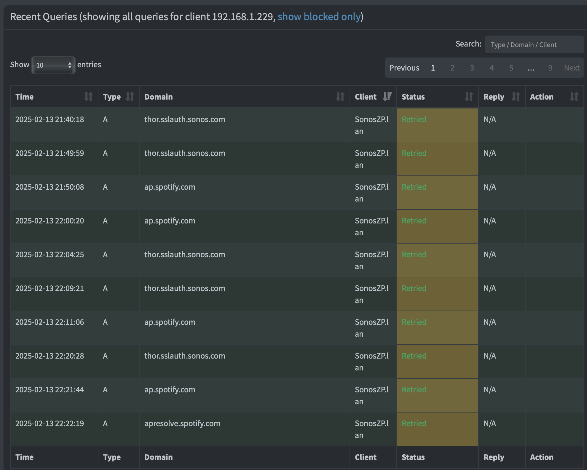

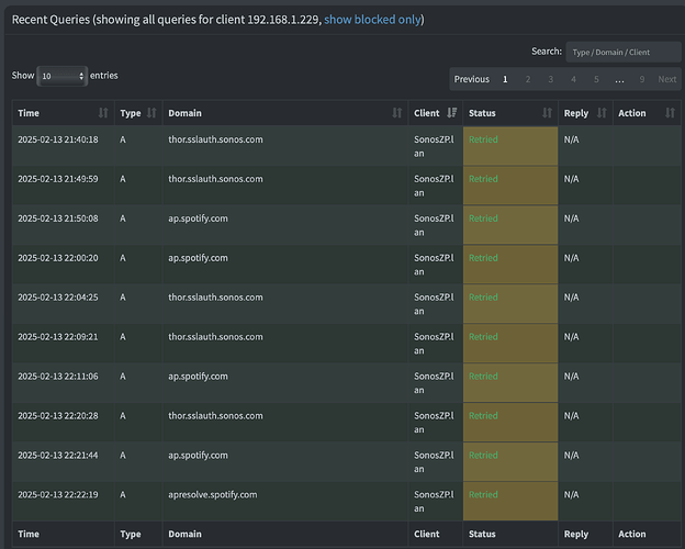

Ok, I checked the requests and it seems that there are a lot of Retried ones...
