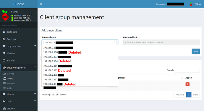

The known clients list is missing numerous devices which are actively connecting to the pihole and the list also contains several devices which haven't connected to the pihole in several months (I know since they were VMs which I've since deleted)
The dashboard claims there are 19 clients, so there should be 19 entries in this list, no?

Yes. In fact, the first eleven entries listed off match the ten entries in the Known Clients list almost exactly. At one point a VM had the same IP as another VM, the second entry when running the above command is the one that gets listed in the Known Clients list.
Maybe it's only grabbing the first ten items?

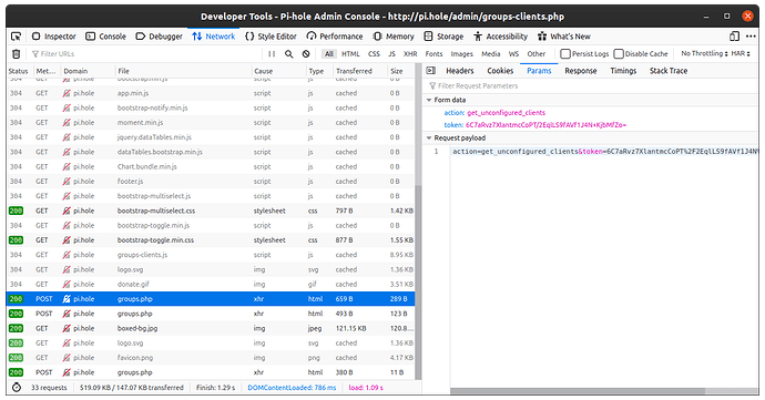

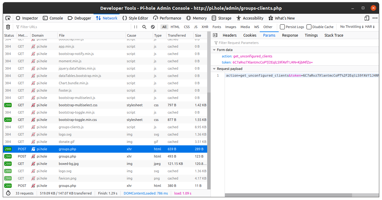

I don't think so, however, I do not have more devices here so testing is difficult. Please open the developer tools (network tab) in your browser and refresh the Group management page. You should find a request like this one (watch out for action: get_unconfigured_clients on the right!):
Check the Response sub-tab on the right. Does it also show all the clients?...
Yes. There's a JSON list(?) with all of the clients. The duplicate entry isn't listed though.

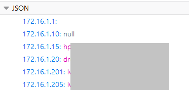

In my case it only shows the first entry of the json. Could the "null" field be the issue?
Correct. Only the first ten entries in the JSON/db show up in the Known Clients list.
@lw1 I also have a null item and it's directly after the last item that appears in the list. Is it the same for you?
Yes, only 172.16.1.1 is displayed. The IPs after the "null" value are missing.
Okay, that's actually interesting. The code should not stop at null, however, it seems sane to avoid these nulls altogether.
