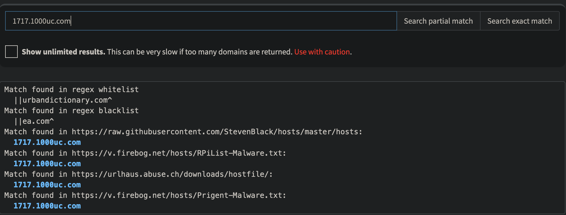

https://tricorder.pi-hole.net/1pkrbgY7/

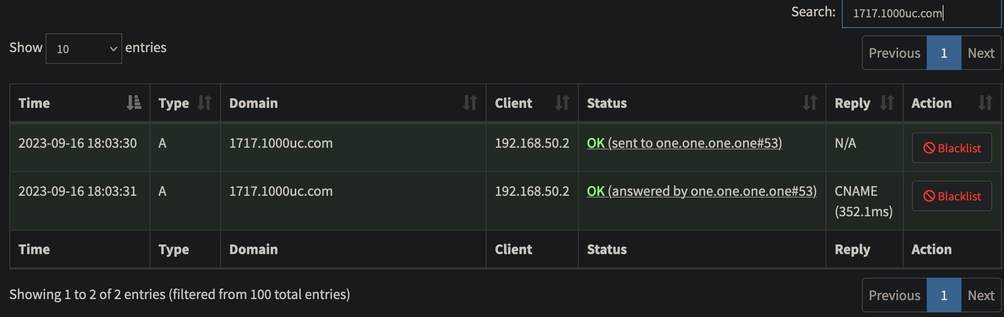

here are some screenshot of what i am referring to:
The culprit is this regex whitelist entry
||urbandictionary.com^
You have a similar blacklist entry (which is disabled) for
||ea.com^
Although the intent was to whitelist this domain, using AdBlock Plus style syntax, as a regex this actually matches everything and anything. And since whitelists always have priority, this single rule is whitelisting all domains.
Delete these two rules and test again. You should find the 1717... domain is now blocked.
To add those two domains back correctly, go to Domains > Domain, enter urbandictionary.com and tick the box Add domain as wildcard. Click Add to Whitelist. Repeat for ea.com and click Add to Blacklist.
