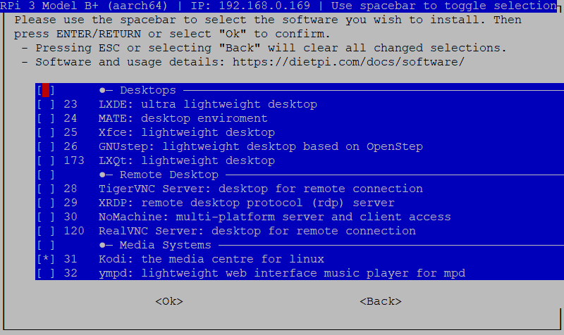

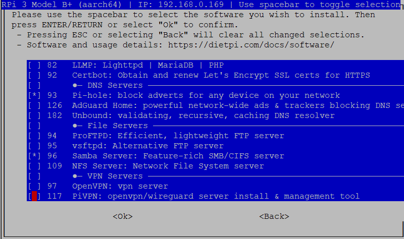

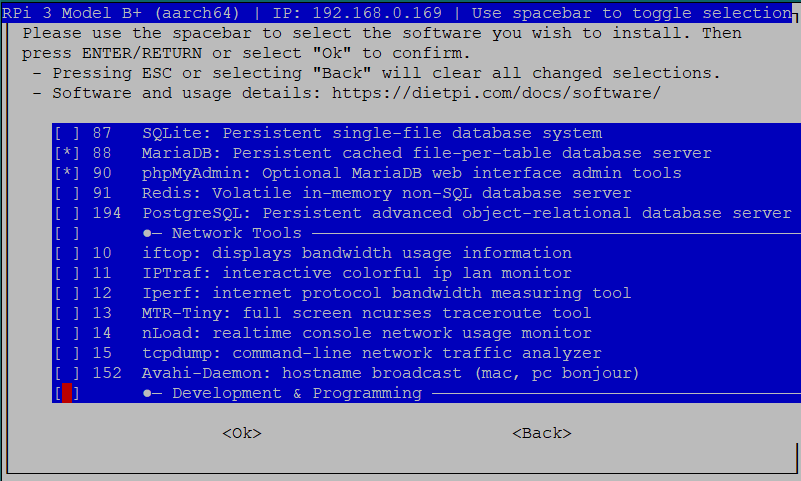

Hi Michalng, here is what i have selected, i selected LEMP with the first install. i dont know why LESP is also ticked.
LESP is ticked because Pi-hole requires SQLite, so you have Enginx, SQLite and PHP installed :wink:. Those stacks are also marked as installed when their individual components have been installed. You require MariaDB for something else?
But strange is that SQLite is not ticket in the same turn. You didn't uninstall it manually, did you? AFAIK the stack is not unticked when one of its components is uninstalled. Actually that would be smart. Same way it would be smart to show at least a warning when a dependency of an installed software title is attempted to be uninstalled. The new dependency system makes this quite easy :thinking:.
Hi Michalng,
i believe wordpress requires MariaDB, i also have not uninstalled anything because i dont know everything that might use a particular package and dont want to mess with the system
