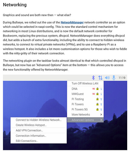

It is not a difference between 32 bit and 64 bit, it is a difference between Raspberry Pi OS pre-Bookworm and Raspberry Pi OS Bookworm.
https://www.raspberrypi.com/news/bookworm-the-new-version-of-raspberry-pi-os/
The documentation of it all is pretty bad but it's there:
https://www.raspberrypi.com/documentation/computers/configuration.html#wireless-networking-command-line
