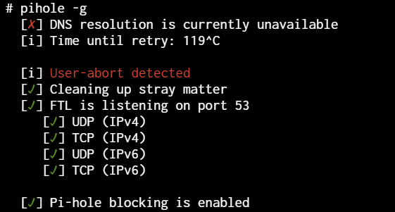

I'm using Pi-hole (as a secondary DNS server) through TrueNAS SCALE v25 and suddenly had trouble updating Gravity:

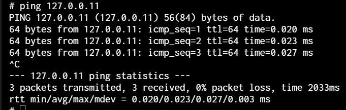

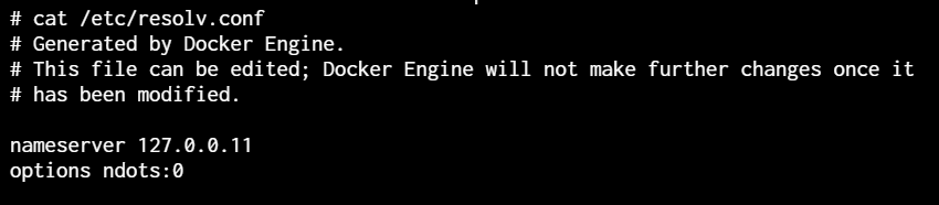

My resolv.conf is showing 127.0.0.11 as the only namespace:
I manually updated the config to look like the Pi-hole running on my Raspberry Pi by using echo "" > resolve.conf, and then Gravity worked, but that's a hack method. I wanna figure out why it's wrong and if I can fix it. It used to work, so maybe something changed in the Docker image?

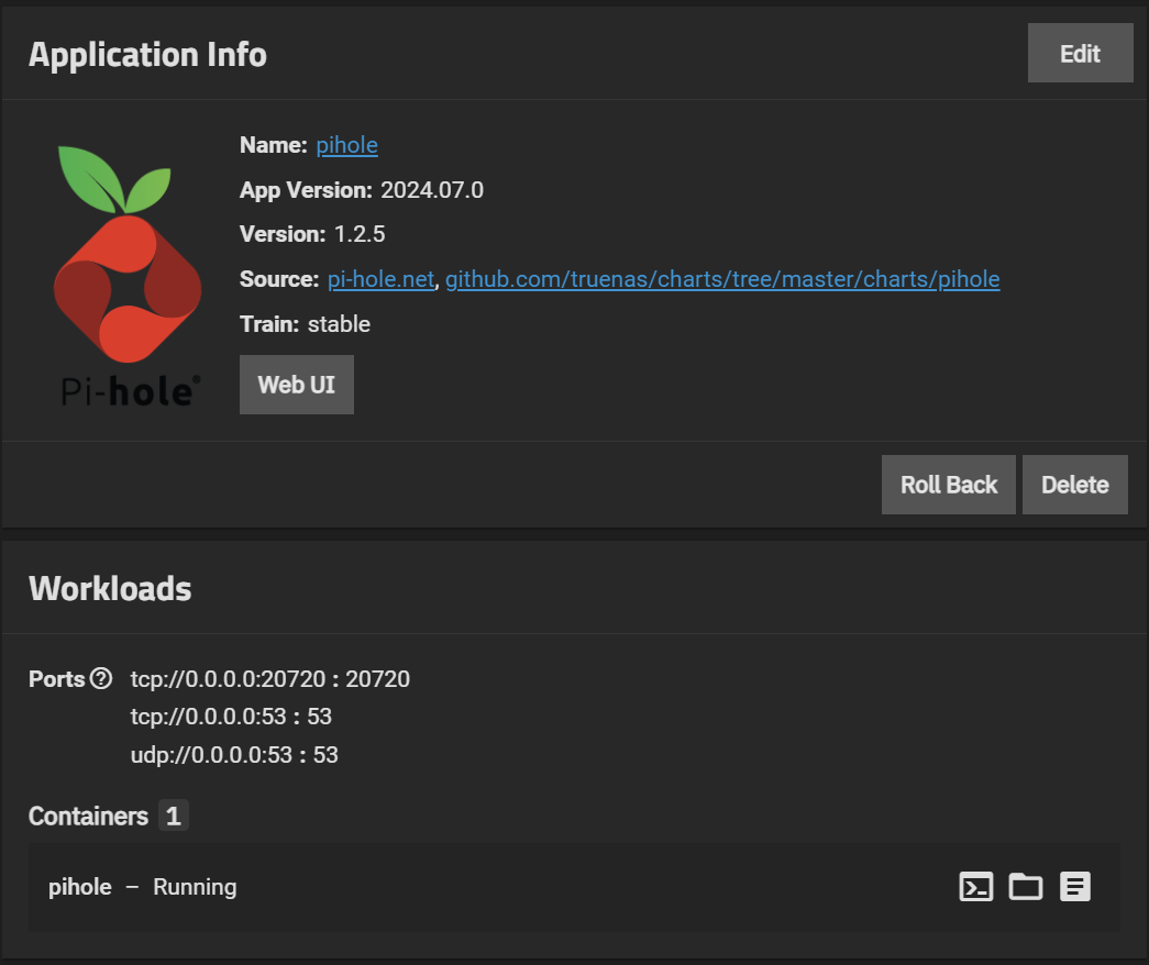

How did you install Pi-hole on TrueNAS?
Note that TrueNAS is not supported by Pi-hole - specifically, the Pi-hole team does not develop nor endorse a TrueNAS Pi-hole app that some users have reported to use.
And please edit your initial post to provide a description of the actual issue you are observing.
I installed Pi-hole using their "Discover apps" method. It's an official TrueNAS UI on top of the standard Docker image.
From what you said, it's not supported via Docker, but I didn't wanna set up another Raspberry Pi for this either.
