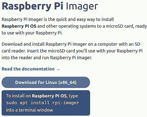

well, i did download the imager from RPI website the day the zero2w was delivered to me. well, copy-pasted “sudo apt install rpi-imager” to install the imager and imager, I BELIEVE, will connect to their own or trusted sources.
That method is only recommended for RPi OS:
On Linux Mint, this would indeed have pulled an older version, probably 1.8.5, judging by one of the comments on the Linux Mint software info:
Out of date, the new pi os breaks the custom boot settings on the current version (1.8.5)
That version can't configure the most current RPi OS images correctly.
You should have used the download from Raspberry Pi software.
