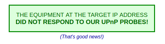

Is this because i set the pi-hole to be the standard DNS in the router settings or is it because I have forwarded the required ports? When i used the ShieldsUP! website as it were suggested in a similar post it said that i were safe.
