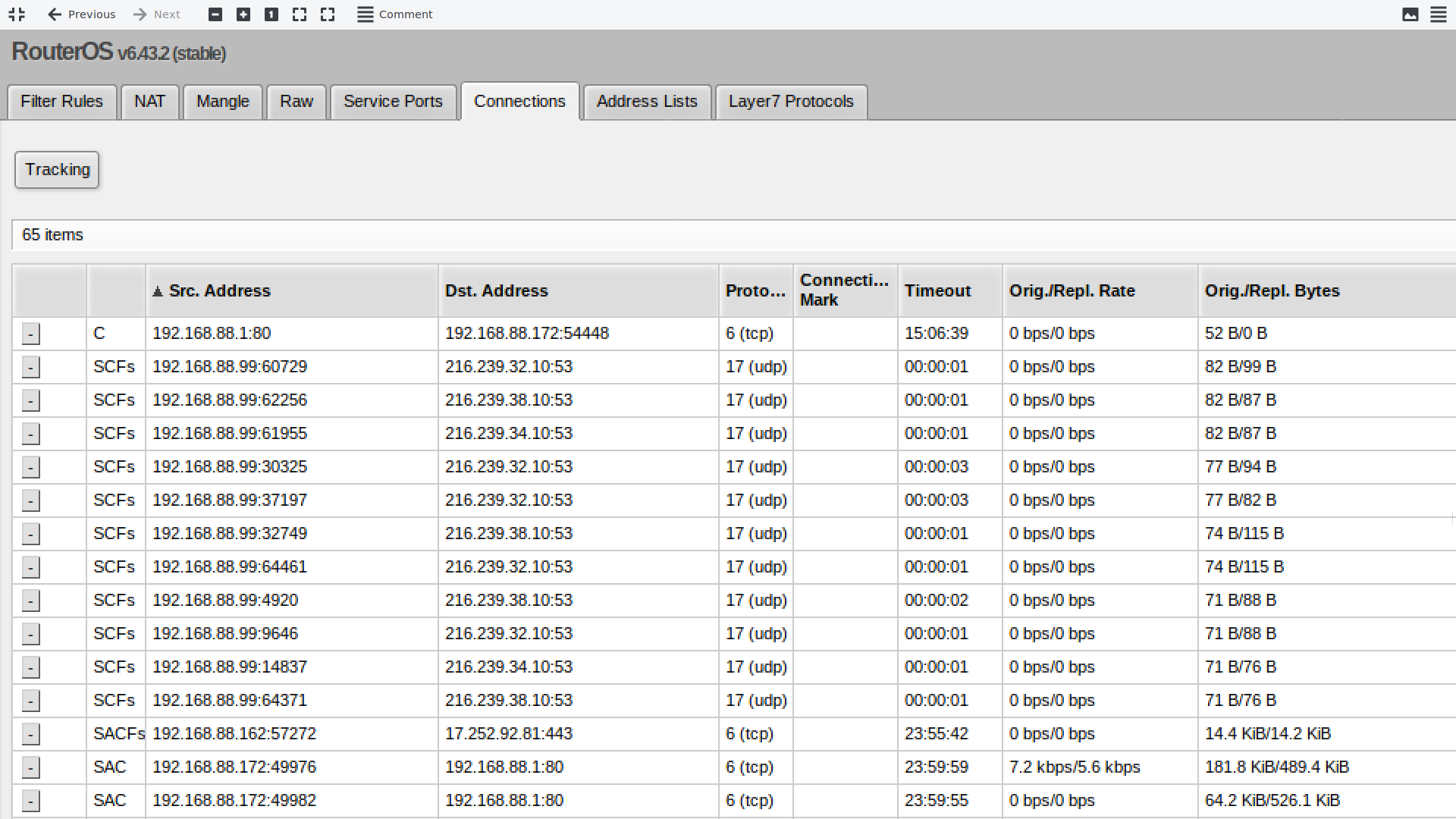

I am using pihole last version with unbound. I am looking my logs in my router when i see this.
192.168.88.99 is pihole
Take a look at the last entry...
NetRange: 216.239.32.0 - 216.239.63.255
CIDR: 216.239.32.0/19
NetName: GOOGLE
All above is root servers . But 216.239.38.10 is normal ??

In the way as you explain it , indeed does not exist something suspect. Ηowever i have a objection here because this is happend with differend url`s that do not belong to any google url.
As exampe i see the same 216.239.38.10 in my logs as visited https://www.in.gr

Likely some other software on your computer is querying a Google domain (Chrome browser, email client, etc.). The Google nameserver IP in your router log might not be related to this specific DNS query.
A quick test - block that Google name server IP in your router firewall and see what application no longer works.

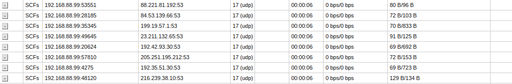

So i disconnect all devices from my network and i have only this. Running swagarch linux and firefox browser. Nothing with gmail or google services etc. My android is closed. I am waiting 5-6 minutes and start browsing to discourse.pi-hole.net
No comments..
192.168.88.99 pihole
There is nothing in the DNS trace path to "discourse.pi-hole.net" that goes through a Google name server.
There is an option in an unbound configuration for verbose logging - that may help you figure out what's calling the Google name servers.
Did you try blocking that google name server IP?
