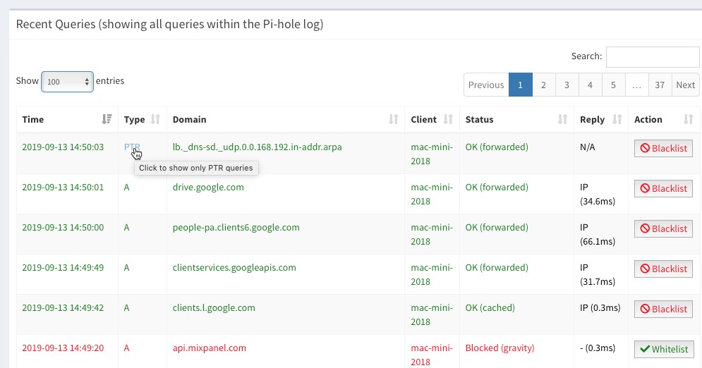

With that said, I could see such a feature being useful; in the Query log page - "filter by protocol"
With that said, I'll check the logs when I get back this evening in hopes of finding the culprit behind these requests - though I'm leaning toward glasswire firewall
This feature exists. If you click on the PTR listed on a line in the query log, Pi-Hole will show you a filtered output containing only PTR requests.
