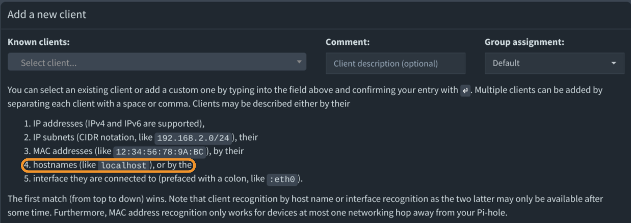

Yeah, I understand that but the client page on pihole mentioned I can use host names
So I was hoping I could just use that for filter through, but It seems like MAC is required. Maybe I’m understanding this incorrectly.
You can use hostnames, but not every OS sends the hostname when MAC randomization is used.
I do always see the same names in the pihole DHCP, my assumption was that these are the hostnames, is that not the case ?
