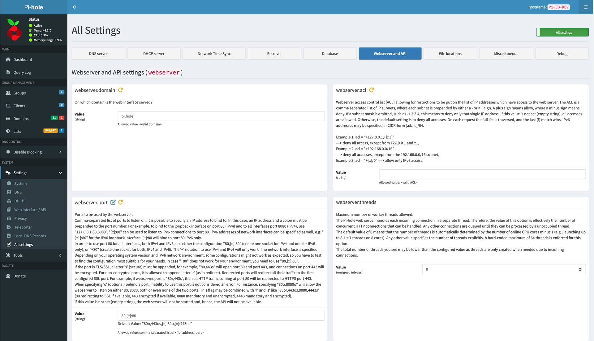

This setting is also available in Expert mode on your web GUI interface:
Yes, it is there. Although I don't think it is enough. (or it was not enough for pihole5). I changed it too, worked almost perfectly, just pihole debug was complaining about apache2 and port 80. That actually did not influence functionality. And it is all gone, since I have upgraded to pihole6 with default settings.
