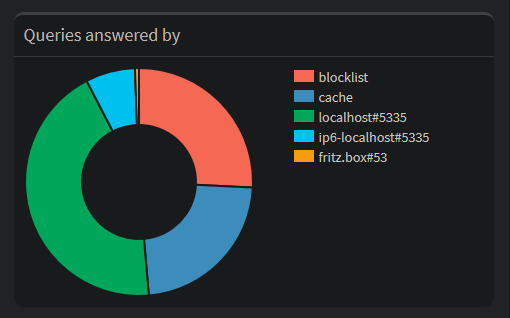

Then again, neither of those options would affect the "Queries answered by" diagram, as that is showing how Pi-hole itself has retrieved a DNS answer, including which upstream DNS server it used. Pi-hole may decide to forward a query for a client's dig request to any of its upstreams, i.e. it may go to an IPv4 address now and to an IPv6 address with the next request, completely independent of how that request was received and what type of record was requested.
So there is no reason for concern at all with the diagram.

I already explained that your diagram does not offer any support for that assumption, as it has nothing to do with the way your clients have queried Pi-hole. You'd have to analyse your long term database for client IP address distribution to find out whether that assumption is justified.
In addition, you wouldn't lose any functionality if you'd remove ::1#5335 from your Pi-hole's upstream DNS servers: Even if all of your clients were IPv6 only, Pi-hole would be able to correctly provide DNS resolution by using just 127.0.0.1#5335 as its only upstream (or vice versa for IPv4).
