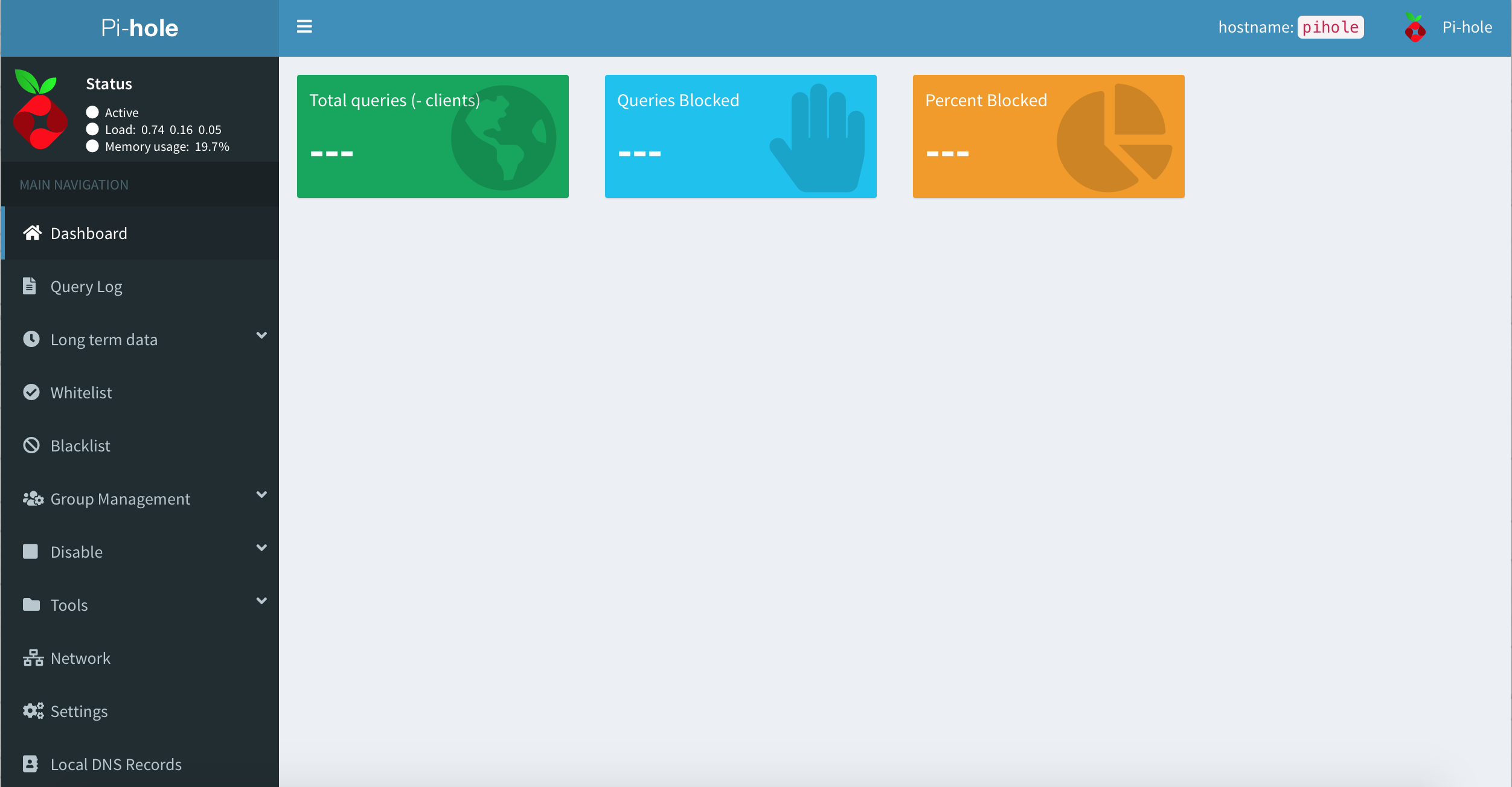

Is gravity.db missing in v5.0?
Very strange. The message
is generated before we even use the SQLite3 engine, it comes when FTL cannot stat the database.

Was happily running 4.x on Pogoplug E02. Saw there was an update and immediately proceeded to update.
Everything broke. FTL never installed in the past, so wasn't expecting anything different.
So cloned and compiled FTL locally and replaced the one in /usr/bin. Things were somewhat running.
No gravity.db. Manually ran the command to create the db. Good, but now I can't change anything.
Permission denied. After spending a lot of time trying to fix this, did a pihole -uninstall.
Then downloaded the install script, modified it to use my compiled FTL and installed. Voila!

Same exact issue, updated from 4.0. Same error, missing gravity.db.
sudo bash -x /etc/.pihole/automated\ install/basic-install.sh
Fixed it for me. Thank you!
I had also the same issue and
worked for me.
Great fix. Nowhere I found any reasonable hint until I discovered this thread. And spent hours.
I am sure that the upgrade process must have a bug. I did it from a pretty fresh v4.x and it failed as well with the missing .db.
Thanks very much to all!
