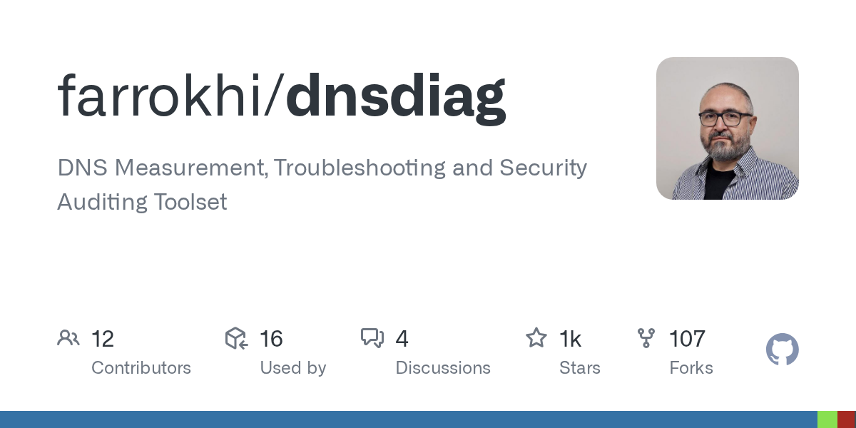

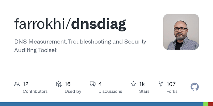

This looks like a good place to leave this.
Unfortunately I have no experience
