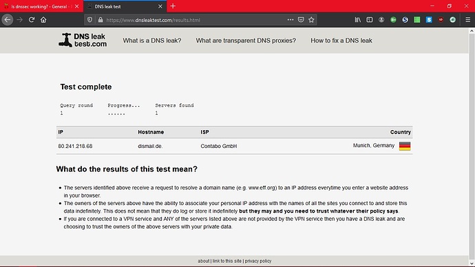

DNS leak test returns surfnet in the Netherlands
It's working!

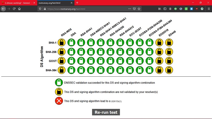

Just cannot get dnssec to work.
Changed to cloudflared and still failing tests

Try that dismail.de it does dnssec you have to input the information from the website manually. It's not in the stubby.yml

For some reason i cannot get dismail.de to resolve.
If i set it in my stubby.yaml nothing is resolved.
If i switch to any other upstream it works OK...

Can i ask why you say this?
Having a quick play with the stubby.yaml file, if i enable dnssec it seems to work OK, when using cloudflare for example?
dnssec: GETDNS_EXTENSION_TRUE
dnssec_trust_anchors: "/var/lib/unbound/root.key"

No privacy gain. It could be dnssec breaking dismail.de that particular resolver is already doing dnssec so you doing it also could break it
