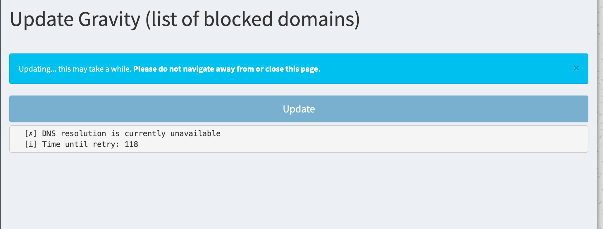

I also can't update gravity with IPv4 Upstream selected

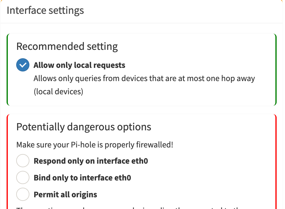

I currently have the following setting:
But from my understanding changing to the potentially dangerous options shouldn't be dangerous if 53 isn't exposed (port forwarding).
For some odd reason my router forwards that port even though I don't want it to.
See the docs linked below those options. The local option means Pi-hole is only responding to clients on the same subnet, and this is perfect for the vast majority of home users. The potentially dangerous options open it up progressively until Pi-hole is responding to any request from anywhere.
As long as you are happy that the only access to Pi-hole can come from trusted devices and networks, you can use those lower options to give the flexibility you need, for example to respond to requests from an adjacent subnet which is also bound to the same network interface.
