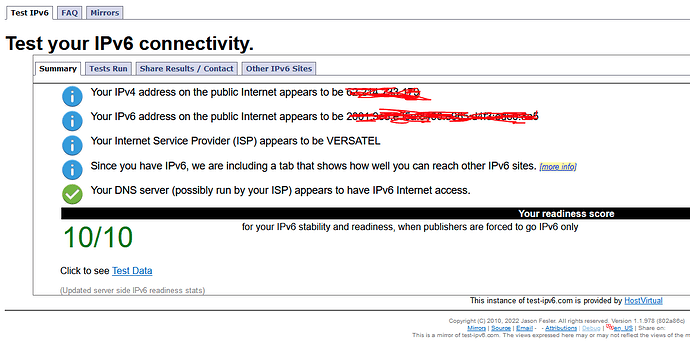

I have no errors so far on both sites. 10/10 and full support on IPv6.
My system: Pi-Hole 5.x + Unbound on a Pi 2B.
System works in IPv4 and IPv6 although IPv6 is not a must.

Also, why would @wd9895 get 10/10 and full support on IPv6 using the same set-up (assuming it's a standard config)? I feel I'm missing something obvious, but can't see what it is
My config runs on a Raspi Pi 2B w. Raspi OS, Pi-Hole 5x stable and Unbound on IPv4 & IPv6, a Fritzbox with native IPv6 connection.
Only cosmetic disadvantage is to see every device doubled in report widgets. One for IPv4, one for IPv6.
If I disabled IPv6 functionality the system also runs properly on IPv4 only.
