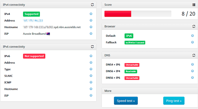

IPv6 setup with issues when testing IPv6 connectivity
I setup IPv6 on my router and in Pihole, but I don't seem to understand why I'm getting failed tests and a warning in Pihole debug.
What does this warning mean and how can I resolve it?
ping6: Warning: source address might be selected on device other than eth0.

Results:
https://tricorder.pi-hole.net/z95f8b21fa
Are you sure your Internet service provider (ISP) offers native IPv6 for you at all? Not all ISPs do.
Yes, I do.
I contacted them to tell them to enable it for my account.
Once enabled and router is also enabled, the router pulls IPv6 address set on Native.
Okay, I was asking because the test page you used did not show an address. And this is entirely unrelated to DNS so Pi-hole will have no influence on it. Are you sure the device on which you ran the test is IPv6-enabled? Does it have a 2403:... address?
yes, it's enabled for my laptop PC. This is where I ran it from.

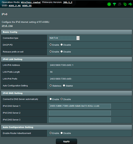

See my screenshot above. The router is not advertising itself, however, it got me thinking that maybe I should populate the empty fields with the same value.
That value you see in the 1st field was taken when I did 'ip -o addr' on the pihole.
Your screenshot shows that your client's nslookup is using your router's IPv6 address for DNS.
If your router wouldn't be advertising it, you could have configured it manually on that client. Assuming you would have told us about the latter, I consider the former more likely.
As far as your router's settings are concerned, you'd have to consult your router's documentation for their exact meaning.
I was referring to my screenshot at the beginning.

No. Typically, you cannot set static IPv6 settings because the prefix will likely be changing every now and then. This would have a great potential of breaking things in totally unexpected ways.
For what? You may need to set this for a VPN which should also route IPv6 but I'd let this disabled as long as you don't have a particular problem you want to solve by intentionally enabling it.
I am aware of that.
It prompted my advice to consult your router's documentation for your settings. Sorry for not making this more obvious. :wink:
Yes, it is what any IPv6 capable router should do by default.
However, your router should also offer options to stop it from advertising itself as DNS server for IPv6 via SLAAC/NDP as well as offering itself via Stateful OR Stateless DHCPv6, which is what you should do using Pi-hole.
Not all routers do support that, though - and if they don't, then Pi-hole will be by-passed as long as IPv6 is enabled.
Again, from your router screenshots, one cannot know how those settings relate to Stateful DHCPv6 or Stateless DHCPv6 or SLAAC, or what the enable/disable radio button in that section does, or whether there would be additional options in some other places.
You'd have to consult your router's configuration or support channels to find out.
