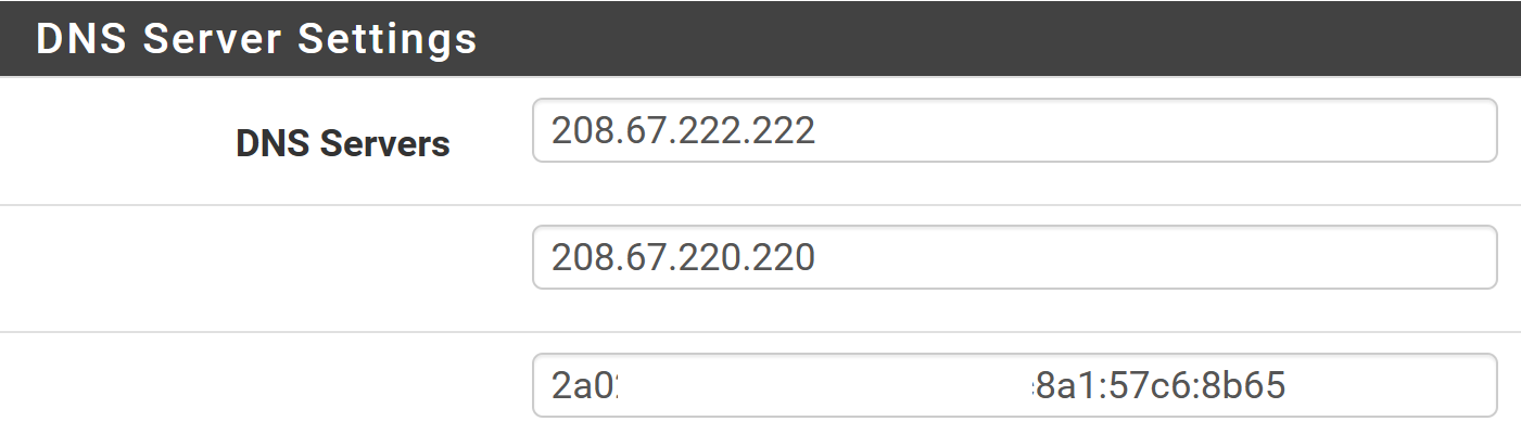

pfsense user here, not the same, I know, opnsense is the same in a lot of ways.
I learned the DNS IPv6 entries, configured on the router/firewall are used to provide the clients with an IPv6 DNS address, they will use.
On pfsense, any IPv6 DNS sever entry, configured in the "system / general setup" page, is used by the client. On this page (opnsense - second screenshot) I notice that there are DNS servers listed.
You might try to enter the IPv6 address of your pi-hole here (and remove all other IPv6 addresses from the list. This works for me (pfsense), IPv6 clients use pi-hole (as long as the IPv6 address, configured in the DNS section of the router matches the address of the pi).
the IPv4 entries ensure the firewall always has access to the internet, regardless of pi-hole functionality. These addresses aren't used to provide the clients with DNS server information (my setup, providing IPv4 DNS addresses in the pfsense DHCP config).
