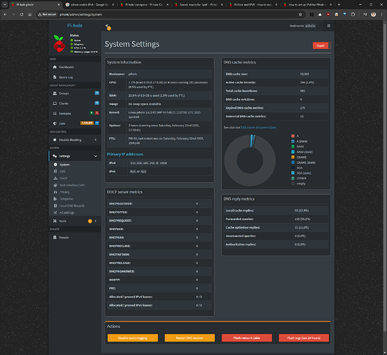

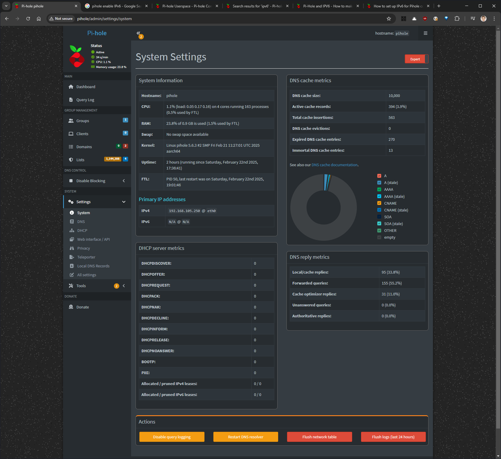

With pihole/pihole:development running on ARM64 on a Mikrotik device as a container:
The IPv6 address displayed in "System Settings" isn't set, and it seems outgoing requests to IPv6 DNS servers fail:
The network has full IPv6 connectivity, and the pihole instance actually recognized its three addresses (ULA, GUA, LL):
I can establish IPv6 connectivity by manually adding the route for the default gateway:
sudo ip -6 route add default via fe80::7642:7fff:fe33:a124 dev eth0
Although that is not in the spirit of IPv6/SLAAC/RA, so I wonder how to fix this permanently and with the router being dynamically assigned.
After manually adding the gateway address, the three IPv6 addresses also appear under "System Settings":
