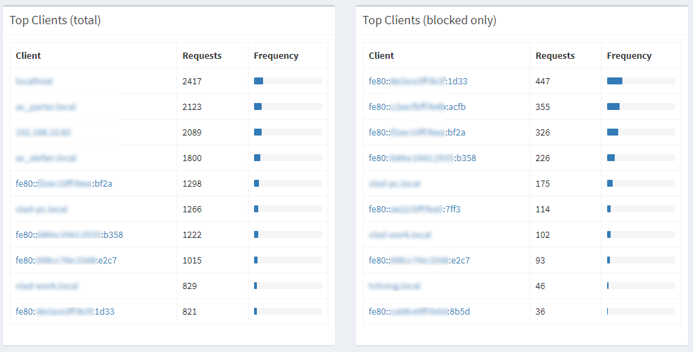

IPv6 LinkLocal resolution for WebUI / PTR records for IPv6
DNS Clients using IPv6 should appear with their name obtainable from the DHCP server (external)
IPv4 name resolution works fine but for IPv6 LinkLocal addresses the resolution is not being performed.

I can also see that even PiHole's own LinkLocal address is not resolved (query for PTR 5.1.0.4.x.x.x....x.0.8.e.f.ip6.arpa is served with NXDOMAIN)
