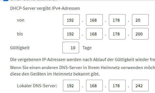

Your most recent debug log indicates that your router is now distributing your Pi-hole host's IP as local DNS server:
   * Received 548 bytes from eth0:192.168.178.1
     Offered IP address: 192.168.178.43
     DHCP options:
      Message type: DHCPOFFER (2)
      router: 192.168.178.1
      dns-server: 192.168.178.242
      ntp-server: 192.168.178.1
Note that your router's DHCP server would offer a different IP (.43) then the one your Pi-hole laptop currently holds (.242).
That may suggest that you haven't configured a fixed IP address for your laptop in your router.
You should change that in your router.

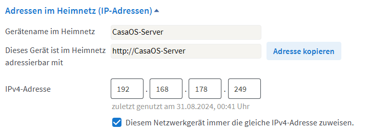

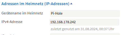

mh weird because i did fixed the ip of my laptop and on my pi-hole there is no option
and i did use the setting reset feature on my router on my pi-hole (because in the describtion it stand that after using it the network would see it as new device) but after that i saw i got the same address idk if i did use a wrong command on docker

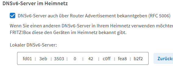

As for my recommendation to not advertise a DNS server's IPv6 address at all:
Your screenshots show that your Fritzbox still does that
That shows still as ticked, contradicting:
Please repeat applying the steps from my previous post.
