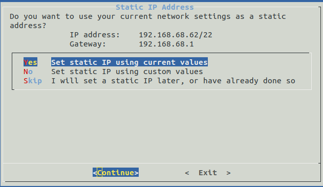

Run pihole -r and select the reconfigure option to get Pi-hole on the active IP and interface.
Thank you for your reply.
I reconfigured pi-hole and made sure the IP was 192.168.68.62, however the debug still shows 10.0.0.113 as the setup variables. Is there someway pi-hole is grabbing 10.0.0.113 from another file after the config wizard completes?
EDIT: I manually edited SetupVars.conf and repaired pihole again, it successfully changed the setup IP, but I still have the same error: https://tricorder.pi-hole.net/p612Yzr0/
Still looking for help. How could I reset whatever internet configurations my device has? I did move from one house to another with a different gateway. Although I searched the debug log for the old IP and I am not sure what else to try.

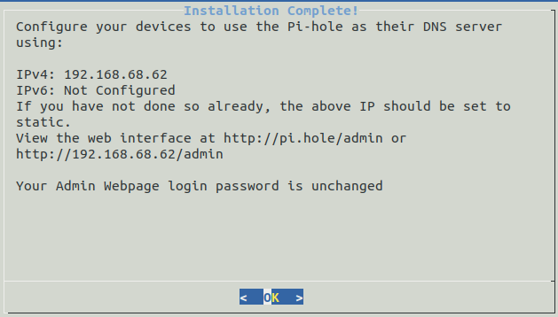

Well I just realized I was using the default policies of UFW, which blocks ports 53 and 67. I followed the instructions here: Prerequisites - Pi-hole documentation and everything clicked into place and my clients connected to the internet and pi-hole is now functioning!
I do appreciate the education on dhcpcd, and netplan. Thanks for your time!
