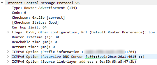

I configured my main router to use PiHole's LinkLocal IPv6 address (since I know that's not going to change even if my ISP assigns me a different prefix) as the DNS server, also propagating it through the network with RDNSS option in the RA packets.

It's okay to use the LL address, but note that our experience showed that not all client accept LL addresses for DNS servers. Sometimes they call this "DNS rebind protection" and sell this as a security measure as they expect an internal DNS server as home as possible security issues as they think that this is an abnormal installation...
