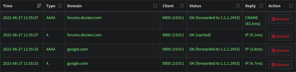

First of all, i have successfully setup ipv4 + ipv6 in combination with docker/pihole. But there is one problem which i'd like to resolve with ipv6.
The problem
All clients on the network that doing DNS requests by ipv6 gets aggregated. This means that all DNS requests are made from one ipv6 address (the gateway address of the docker network bridge) as shown in the 'query log' of PiHole. In this case it's address is: fd00::2:0:0:1
My expectation is that each individual client is shown in the 'query log' just like it does with ipv4 addresses.

When i invoke nslookup from any client:
nslookup google.com 10.0.10.5   --> pihole query log shows ip of the client (so this is correct)
nslookup google.com 2a02:a230:d105:10:be5f:f4ff:fee1:e590 --> pihole query log shows ip of the gateway address (fd00::2:0:0:1, **incorrect**, i would like to see the client ip as well...)

This is not related to Pi-hole:
It is Docker that is NATing traffic crossing the boundaries of its bridge network.
You should consider their documentation and support to address your issue as well.
For a start, you could try to use a different Docker network mode (e.g. host mode) to avoid NAT.

Until very recently I was running pi-hole in a container - and observed the same thing you did. All of my IPv6 traffic was coming from a NAT address due to how docker was managing the network.
I did not try running with --network host but that might fix the issue simply allowing your container to have direct access to the host network stack. I don't know the docker compose syntax (sorry)
I just lived with the limitation (until I caved and got a Rpi4 to be a dedicated pi-hole).
I also explored the macvlan option Docker and macvlan networking (IPv4) – Roo's View - but never got a suitable solution to deal with IPv6 for macvlan (I believe it is possible, but docker + IPv6 is out on the hairy edge of sort of working from what I can tell)
