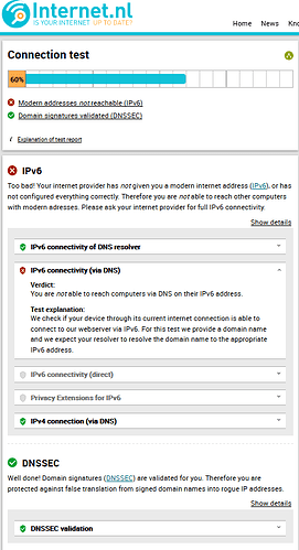

but there does not seem to be DoH over IPv6. My provider supports IPv6 and the router is connected to the provider with DS Lite.

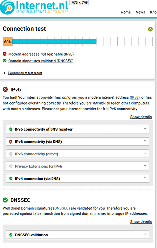

What does https://ipv6-test.com show for your connectivity?
You don't have IPv6.
I do have IPv6
Then something is not configured correctly as the ipv6-test checks for IPv6 connectivity across the internet. And that test said you have no global internet IPv6.
Please see these snipets from pihole -d I do have a global IPv6. DoH is not using it.
Then back to the question I asked earlier, is cloudflared listening on IPv6?
The check on ipv6-test showing that the browser does not have IPv6 connectivity is telling that it doesn't matter if you have IPv6 AAAA records resolved, the client can't use them.
My suggestion is to just disable IPv6 on the router and forget about IPv6. You don't gain anything from having it enabled and it causes a lot of issues for people that are not well versed in networking.
And what if I want to reach a Nextcloud from a user that only provides IPv6?
I cannot disable IPv6 on the router as I only have DS Lite, not Dual Stack.
