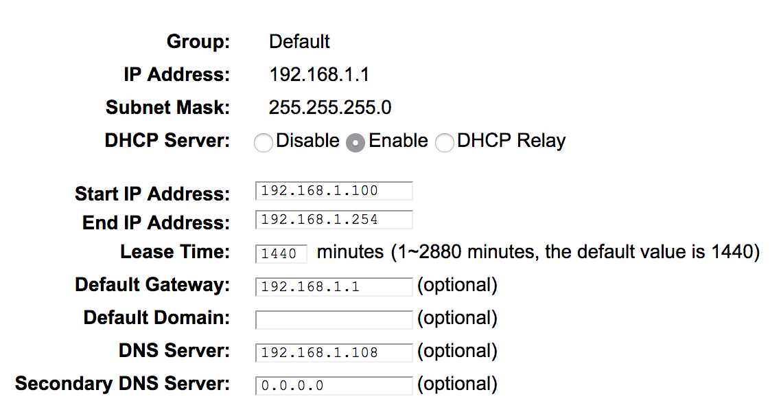

I have set the IP address of the pine64 to be the primary DNS server:
However it still doesn't seem to be working. I have run pihole -d and the notable line was:

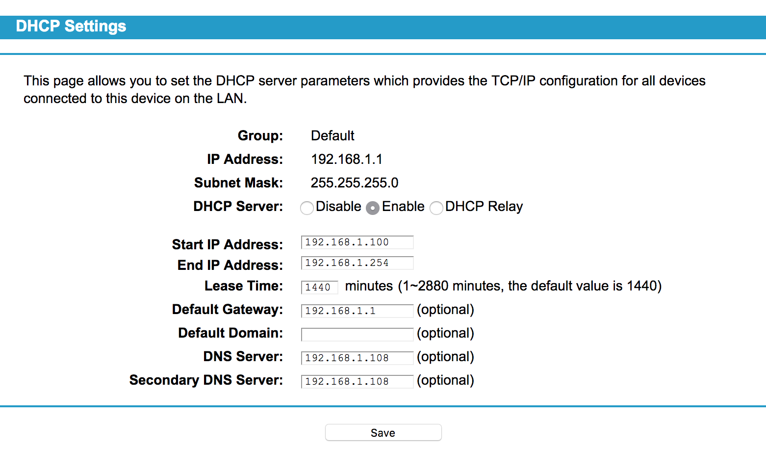

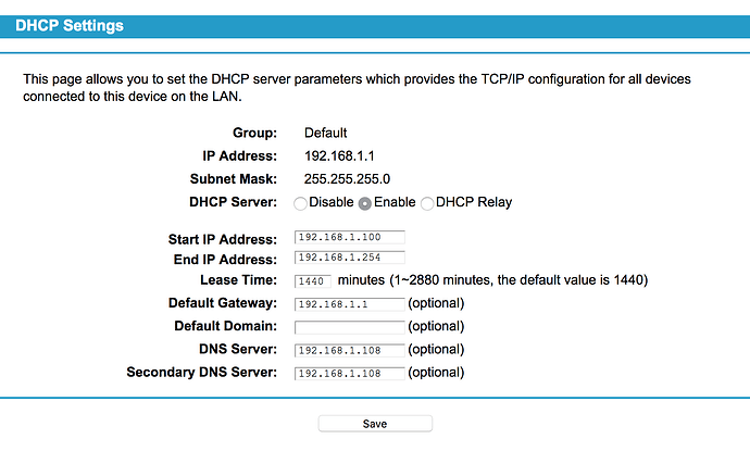

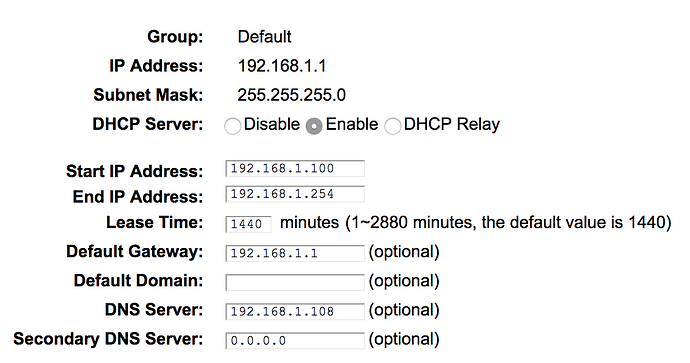

Thanks for getting back to me so quickly. Unfortunately the router I have (TP-Link TD-W9970) doesn't seem to allow the Secondary DNS Server to be empty. I have tried setting both to be the IP of my pihole:
(I also tried setting the second one to 0.0.0.0)
It still doesn't seem to be using the pihole, as it's not appearing on the dashboard, nor is it blocking.
Any other recommendations or things I can do to debug I would appreciate.
