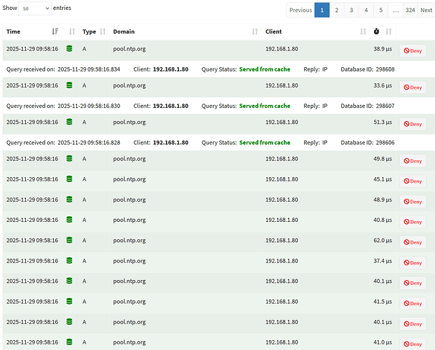

Checked the requests the filter make, nothing is blocked, but… millions of connections to pool.ntp.org :
One each 4ms, it saturate the RPI in no time.
I’ve blocked the IP if more than 500 requests per 60s, it resolve the RPI saturation, but still no connection.

From the data available, I cant determine with 100% certainty if they are all from an NTP client.
But in the first screenshot, they are all green meaning they arn't blocked.
And even if one or all four of the NTP server IP's cant be reached, those DNS records should still stay cached on the client for another sync attempt instead of querying DNS again.
13 queries in one second from the screenshot isnt normal and most certainly wont look good on the GUI pie charts etc.
EDIT: Oh and the queries database file will grow huge.
