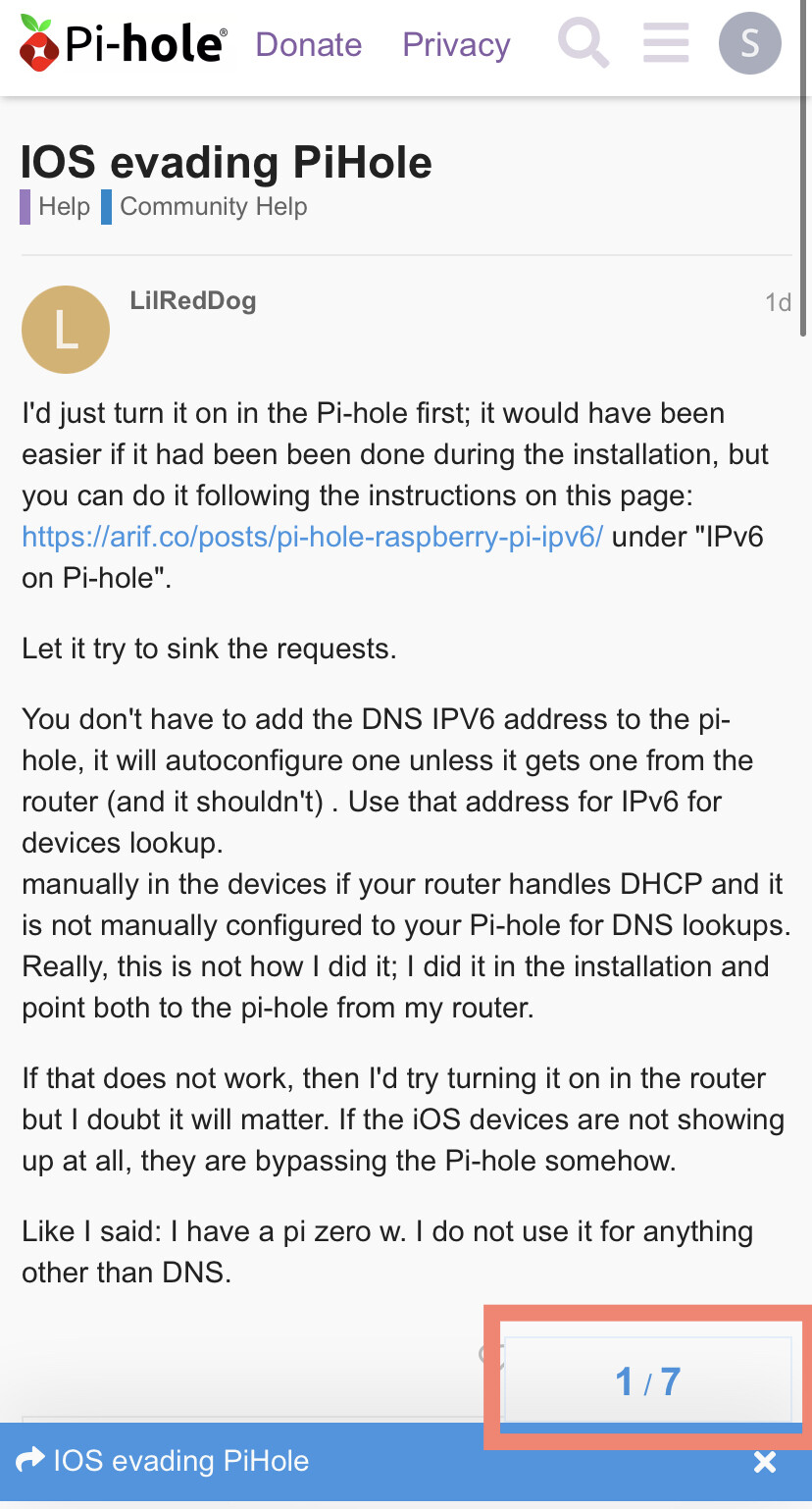

I'd just turn it on in the Pi-hole first; it would have been easier if it had been been done during the installation, but you can do it following the instructions on this page: Pi-hole on Raspberry Pi with IPv6 - Arif Amirani under "IPv6 on Pi-hole".
Let it try to sink the requests.
You don't have to add the DNS IPV6 address to the pi-hole, it will autoconfigure one unless it gets one from the router (and it shouldn't) . Use that address for IPv6 for devices lookup.
manually in the devices if your router handles DHCP and it is not manually configured to your Pi-hole for DNS lookups.
Really, this is not how I did it; I did it in the installation and point both to the pi-hole from my router.
If that does not work, then I'd try turning it on in the router but I doubt it will matter. If the iOS devices are not showing up at all, they are bypassing the Pi-hole somehow.
Like I said: I have a pi zero w. I do not use it for anything other than DNS.
