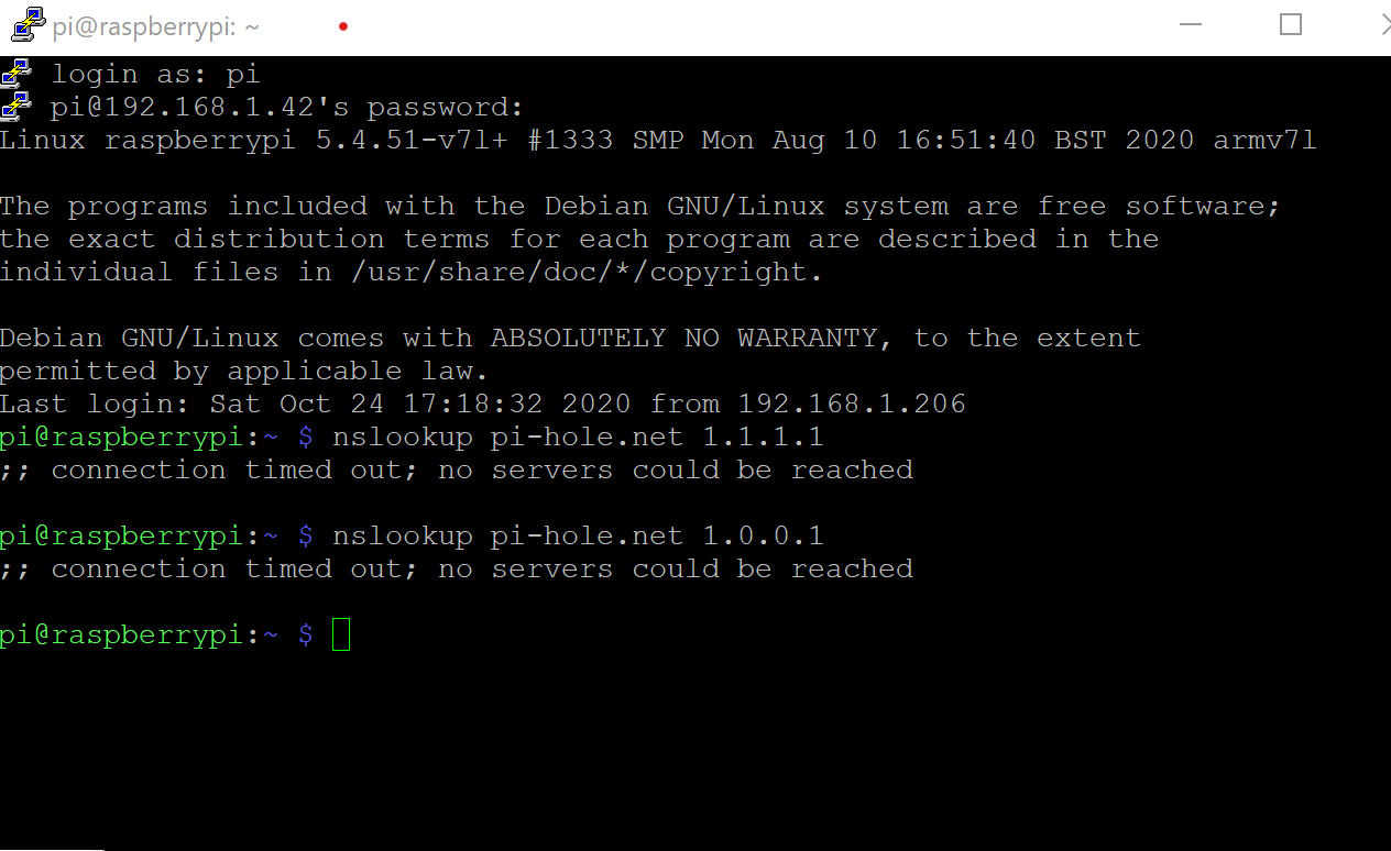

@deHakkelaar after pointing the router back to the pihole this afternoon (~2:00 pm), internet cut out at around 5.
Results from your queries are below:
From the pi-hole
The Windows machine was also unable to connect to anything.
